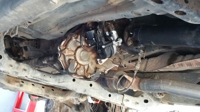

    Local techs say its the tcase actuator...looks like i may get my tacoma back on Wednesday.
    Keeping fingers crossed.
  17. Feb 28, 2016 at 6:41 PM
    #17
    mistermanny
    mistermanny Well-Known Member
    Feb 25, 2015
    #149565
    271
    Jalisco, Mexico
    05 AC 4x4 2.7 5spd
    OME 883/Nitros
    Got the rig back...it was the tcase actuator.
