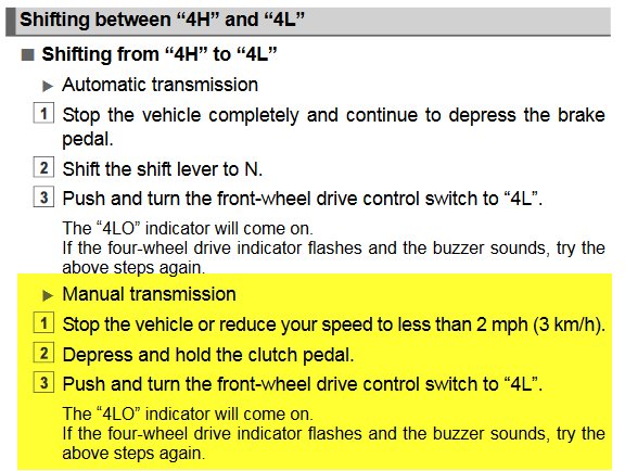

    Is this the sequence you tried?

    Assuming 4wd high is already engaged:
    Stop
    Take the transmission out of gear
    Hold the clutch all the way down against the clutch pedal switch
    Turn the 4wd selector to 4wd low
    Wait for it to engage and all the lights to come on.
    You can usually hear 4wd low engage.
    Also "exercise" your 4wd system how ever many miles, however often the owners manual states. It will work better if you do this.
