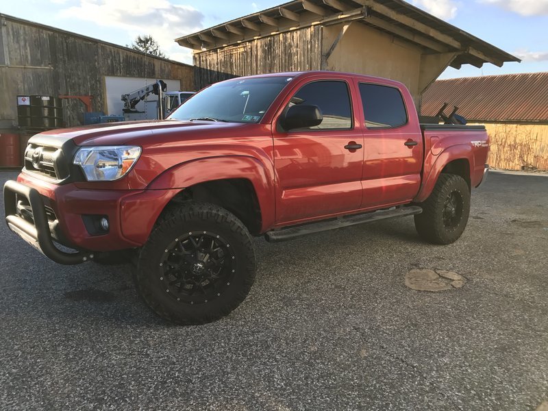

    I currently have a 3" lift with 33s on my 2014 Tacoma, 3" is just a little small for me and 6" is too high with 33s in my opinion. Would it be worth the money to go to a 4" or 5" and would I be able to tell a difference from a 3" to a 4" lift?
    Also what would be some good 4-5" suspension lifts for under $1500
