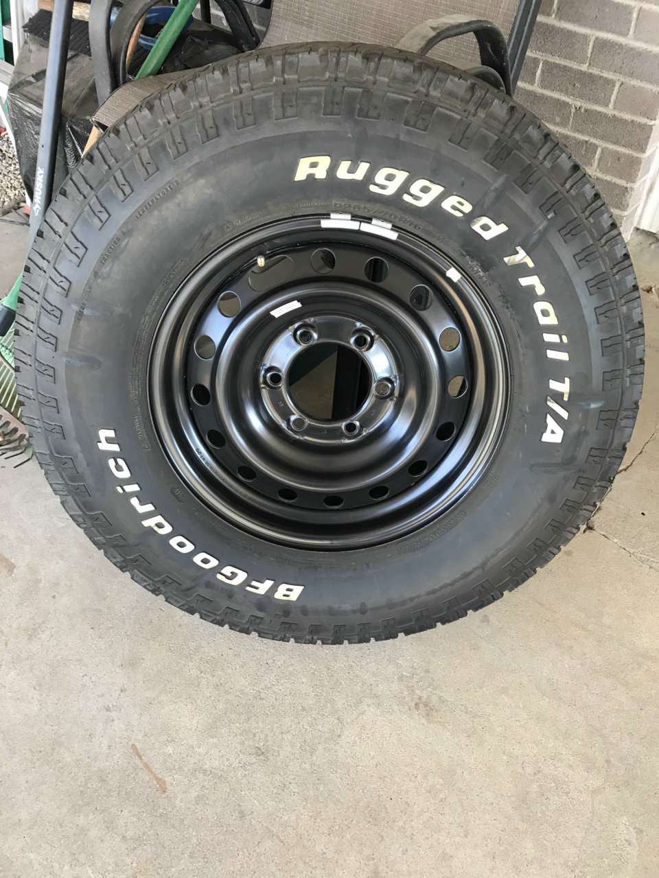

    My concern was getting a flat in nowhere lands. I made the decision to purchase 5 tires and matching rims. I know my spare will fit. 275/70/R17.
    It also fit in the spare tire area mounted underneath.
    My son didn’t want to , but he knows I will lend him my spare. We carry the same size rims/tires and off-sets.
    How many of you brought 4 or 5 tires and rims?

    I have a matching tire and wheel for a spare. It was a tight fit underneath but I got it in there. I originally purchased the wheels and tires for a Bronco so I bought 5 because obviously the Bronco spare mount is visible.

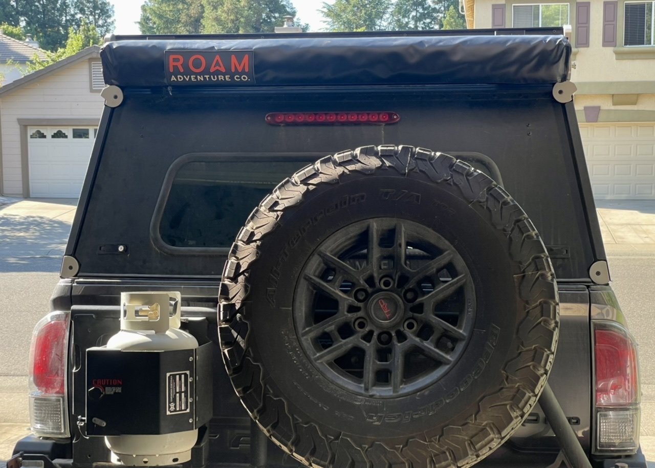

    I use a full size spare and it has non-theoretically saved part of a trip.

    I carry another spare when going off the streets......a fb find for only $40 .......the tire has never been used.......hopefully will be easier than dropping the spare

    Since my spare is underneath, I bought a 17" steel spare. I then mounted the 5th 265-70R17 to it. If it was mounted in a more prominent position then I would have got a matching rim as well.
