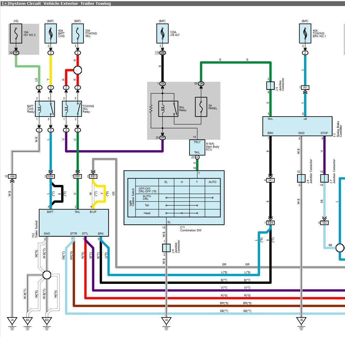

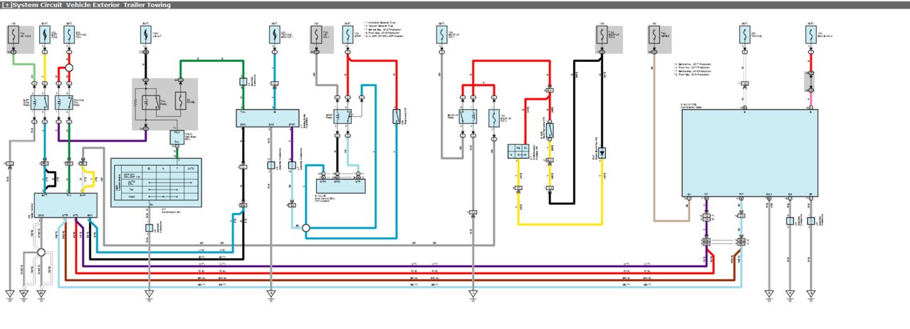

    Quite a few fuses and relays are used with trailer lights.
    This is hard to read but is an overview:

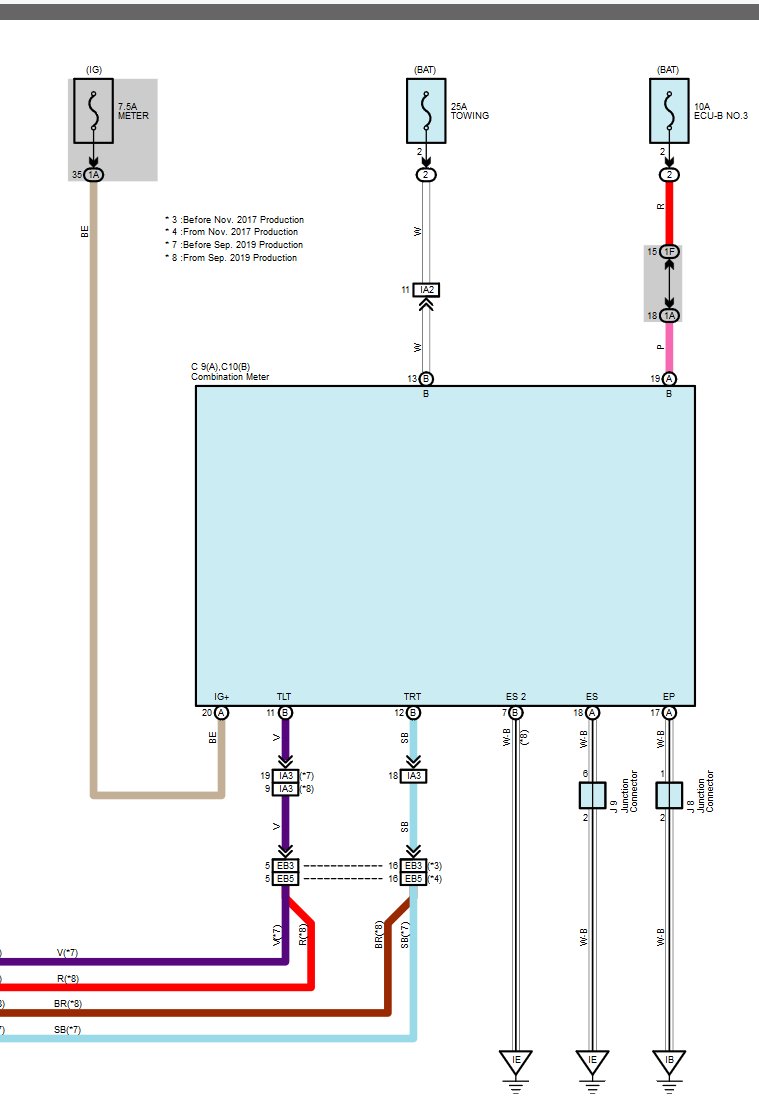

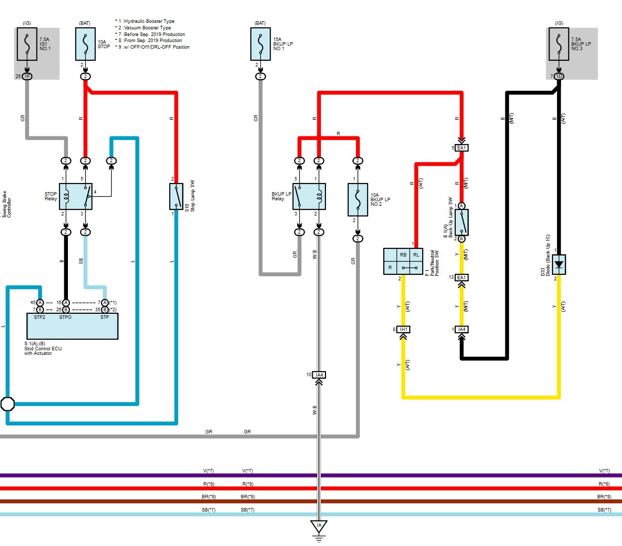

    The next three are blown-up (easier to read) sections from left to right:

    Check all fuses. If all fuses are good, then I would suspect a missing ground issue on the trailer is causing problems.
    Tail lights will light up without a ground as they can sneak a ground path back through the turn/stop filament.
    Are running lights on, but everything goes off when stepping on the brake? That's a bad ground issue.
    scouterjan[OP] likes this.

    The stop, and turn lights come from the combination meter.
    The combination meter portion of towing is power by the 25A towing fuse.
