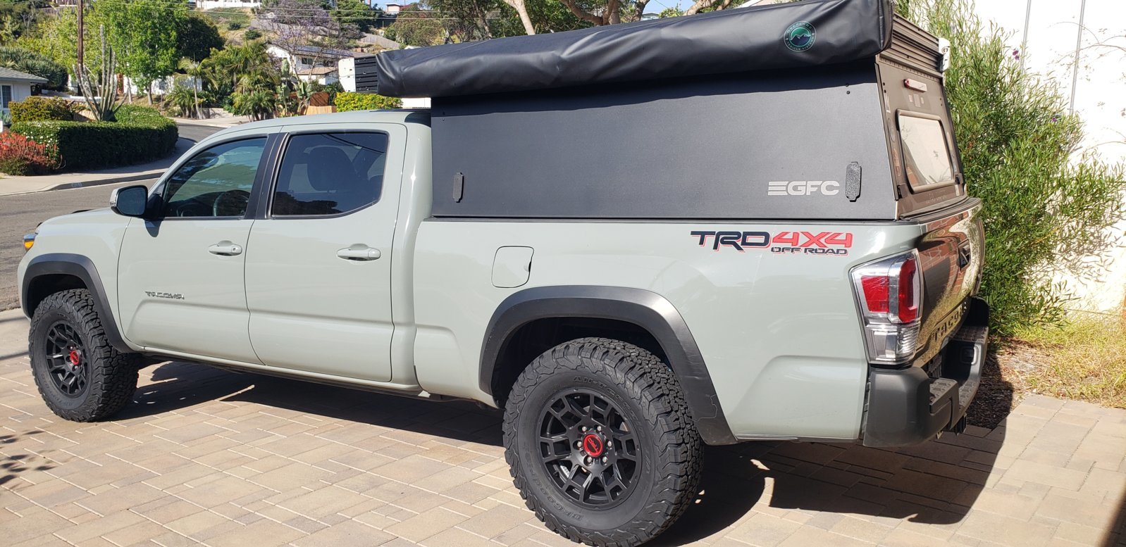

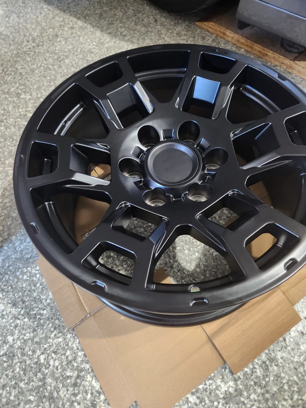

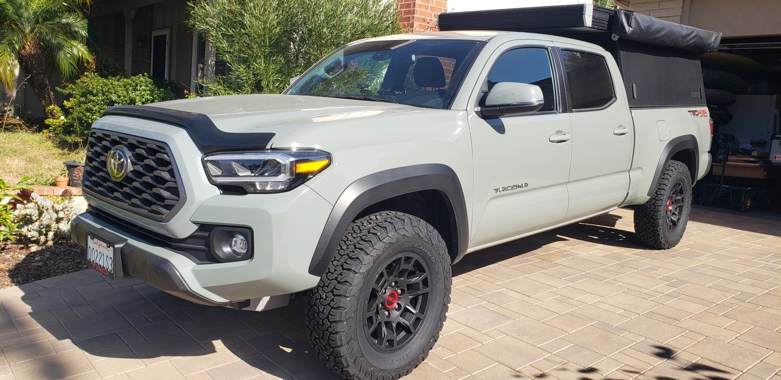

    The PTR56-89210-F2 rims fit, no issues observed. Check the pics below.
    Prior to the install today I did some final calling around for additional recon, here's what I got:
    Carlsbad Toyota - they said the rear hub fits more tightly on Tacoma with these rims, and the mechanics have to really work to get them off sometimes. Then the guy said they recommend 10mm spacers. In my mind I thought "WTF, your fellow tech 4 weeks ago said they were fully compatible, no issue".
    Off Road Warehouse (San Diego) – call took less than 30 seconds, they said they install these all the time on 3rd Gen, I'll have no issues.
    Off Road Warehouse was on the money. Had these installed by Costco, since that’s who I ordered the tires from. And Costco are sticklers for things being correct - had to waive their usual warranty, since it wasn't the 16” factory OEM. The tech confirmed they were a good fit.

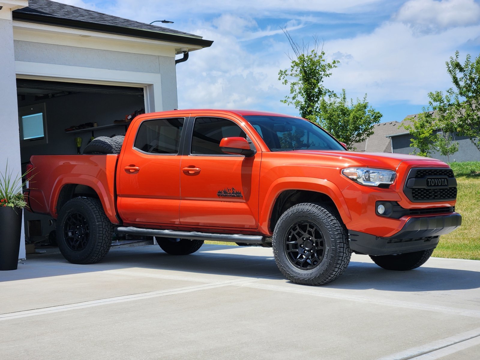

    Just got my agp wheels installed today, love them. They are the 21+ pro replicas but without the interference issue, and they stick out just a little further for a better stance.
