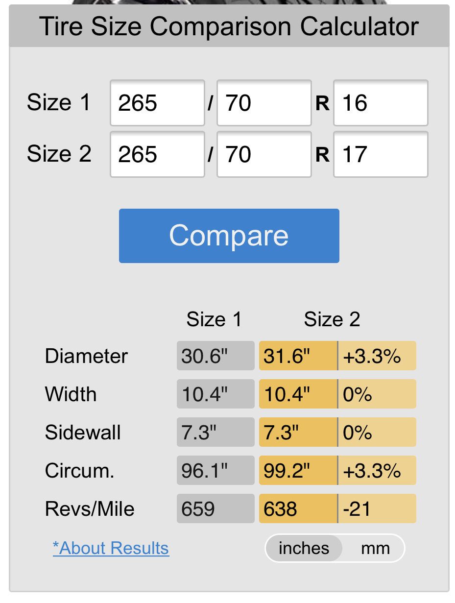

    if I get 17 inch pro 4 runner wheels on my taco would it give me more ground Clearance ? Vs my stock 16 inch OR wheels.

    Only if you put larger diameter tires on them.

    17" SEMA wheels with 265/70/17 will give you about an inch of additional clearance.

    The tire is 1 inch taller but only half inch more under the axle. 285/75r17 gave me just over an inch over stock 265/65r17

    It’ll give you an inch in diameter, a half inch in ground clearance.

    Yeah 1.04 in. taller .52 ground clearance

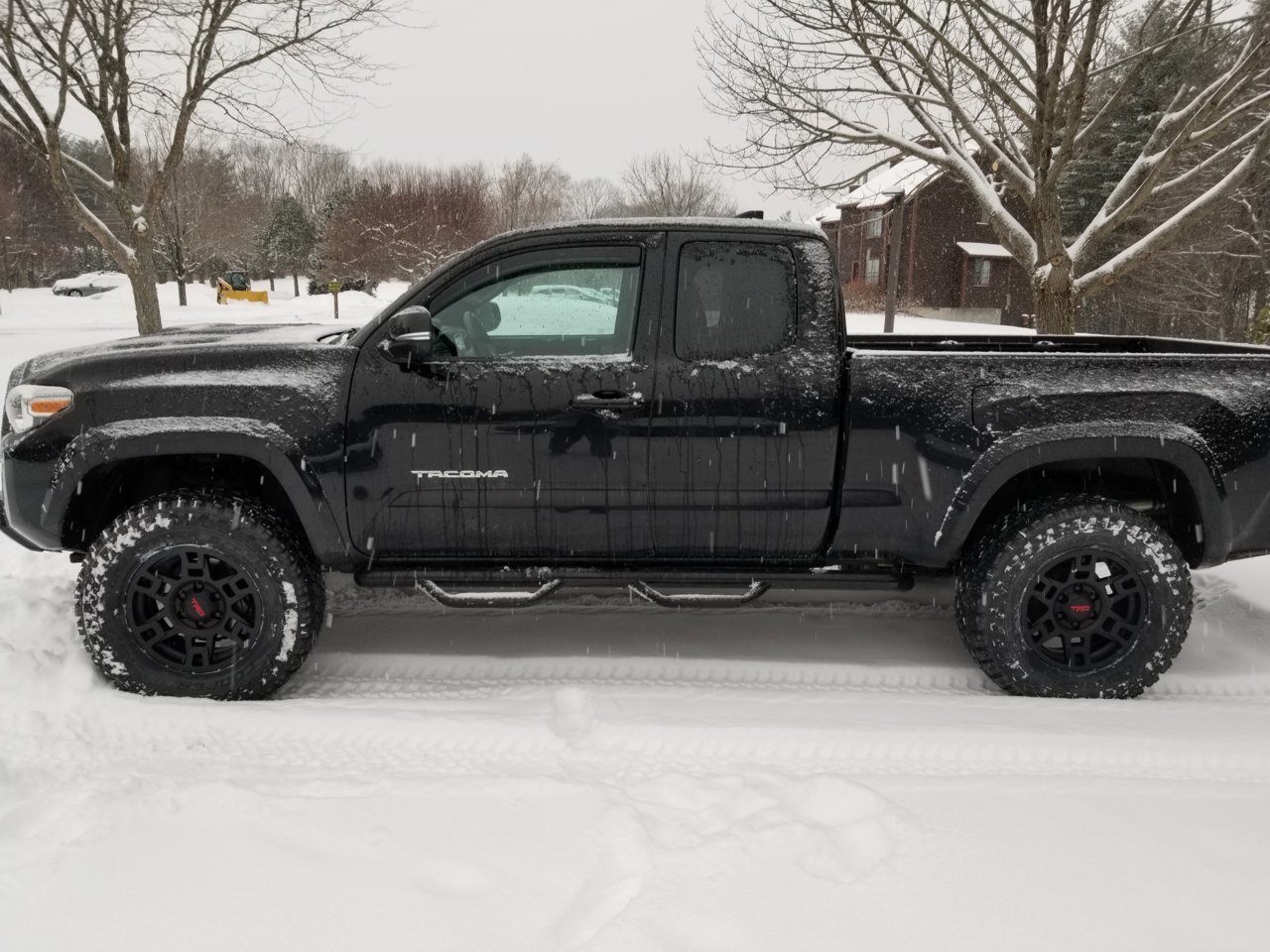

    Full trd pro suspension. Toytec progressive add-a-leaf pack (with overload in). Sema trd 4runner rims. 285 70 17 ridge grapplers. Satoshi grill.
    What do you torque the lug nuts to

    85 ft lbs
