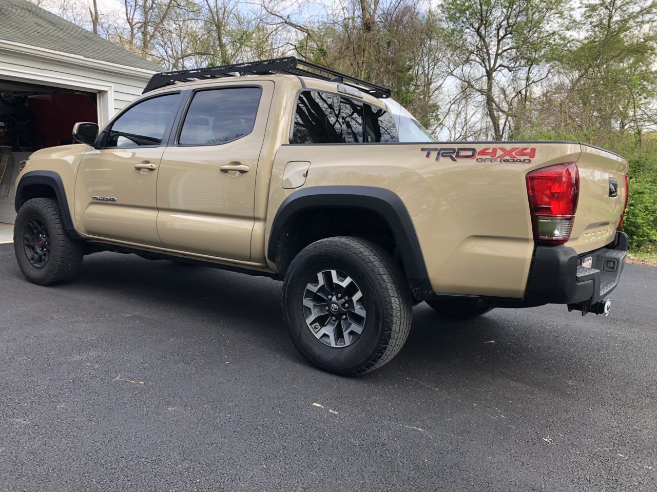

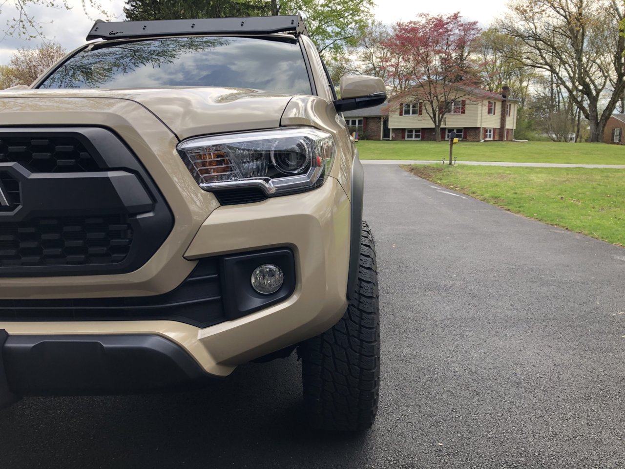

    PICTURE 1:
    Stock

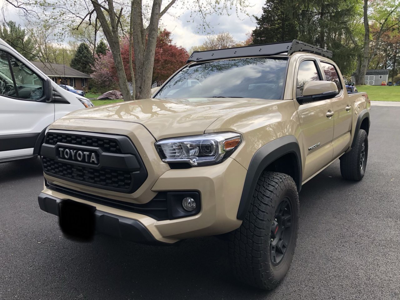

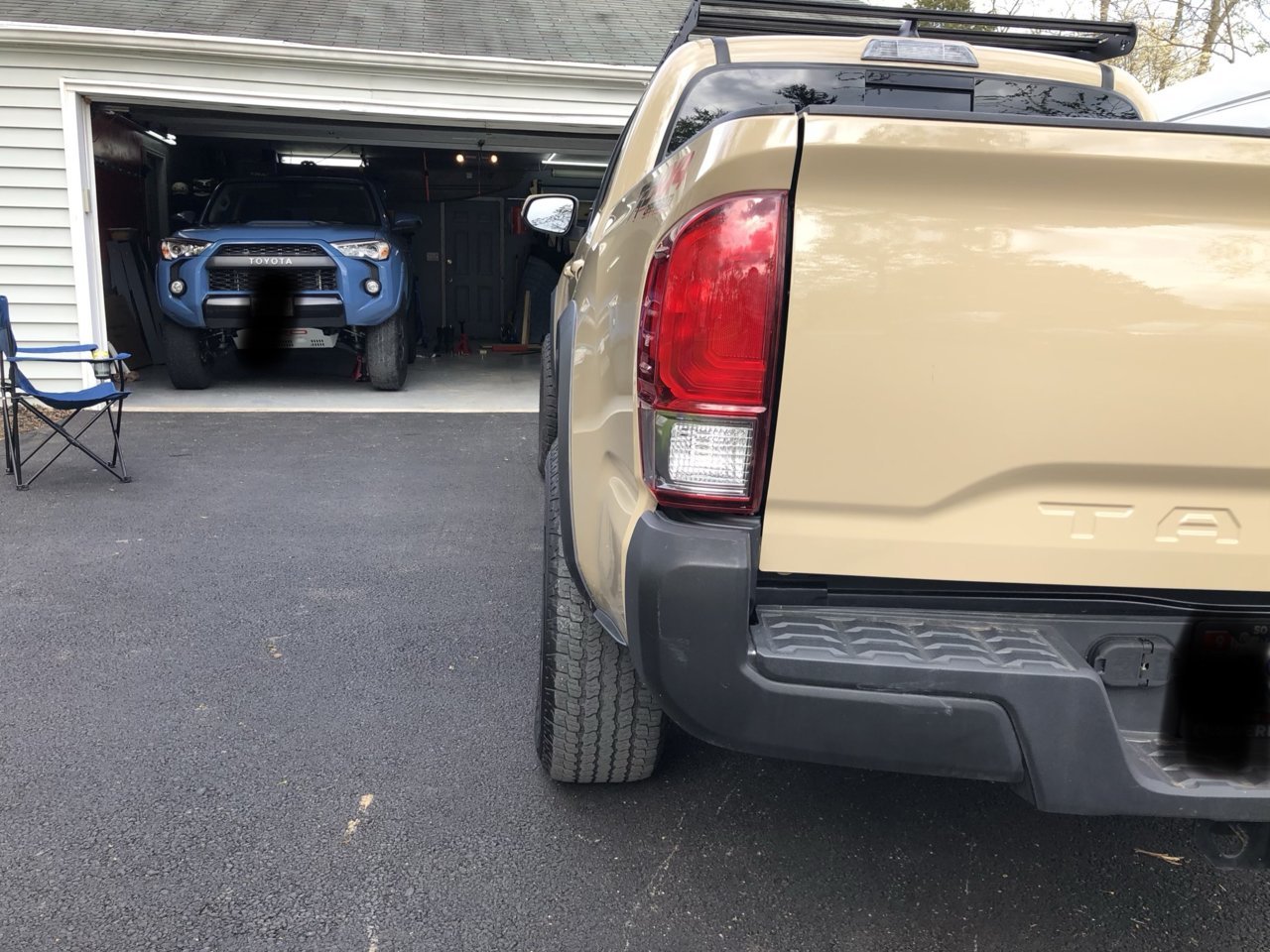

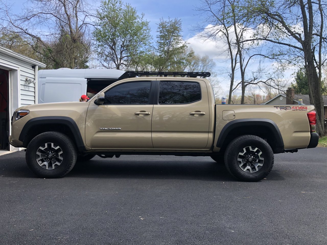

    PICTURES 2-6:
    With the wheel / tire installed. Love the look, appears much more aggressive than stock.
    tacoma side.jpg tacoma side rear.jpg tacoma side front.jpg tacoma front.jpg tacoma rear.jpg

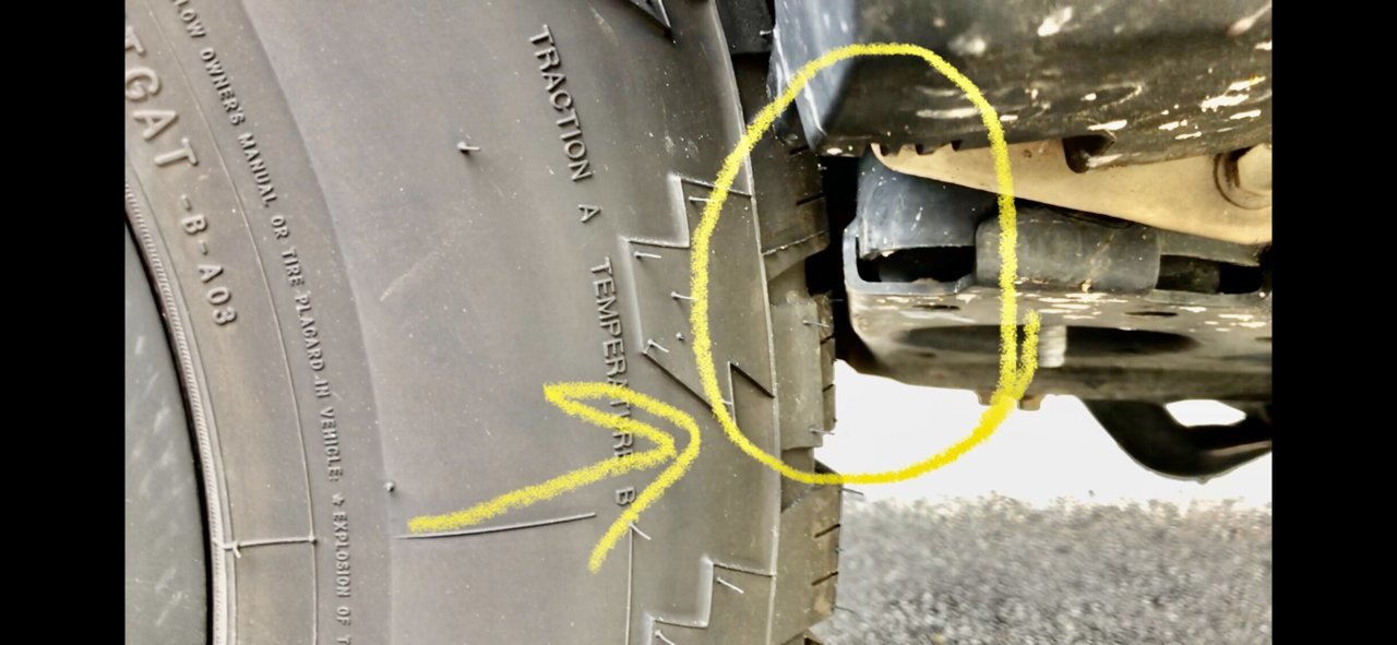

    PICTURE 7:
    On to the rubbing issues. This picture is of the tuck on level ground, the front driver wheel is turned approximately 80% to the left, which seems to be the position where the tire is closest to the cab mount. As you can see the tire rubs on a small piece of the plastic wheel well liner near the cab mount (not a big deal). More importantly there is only a very small gap between the cab mount and the tire (I did not measure but would estimate approximately 1/4" gap between the tire and the cab mount)tacoma cm gap no flex.jpg

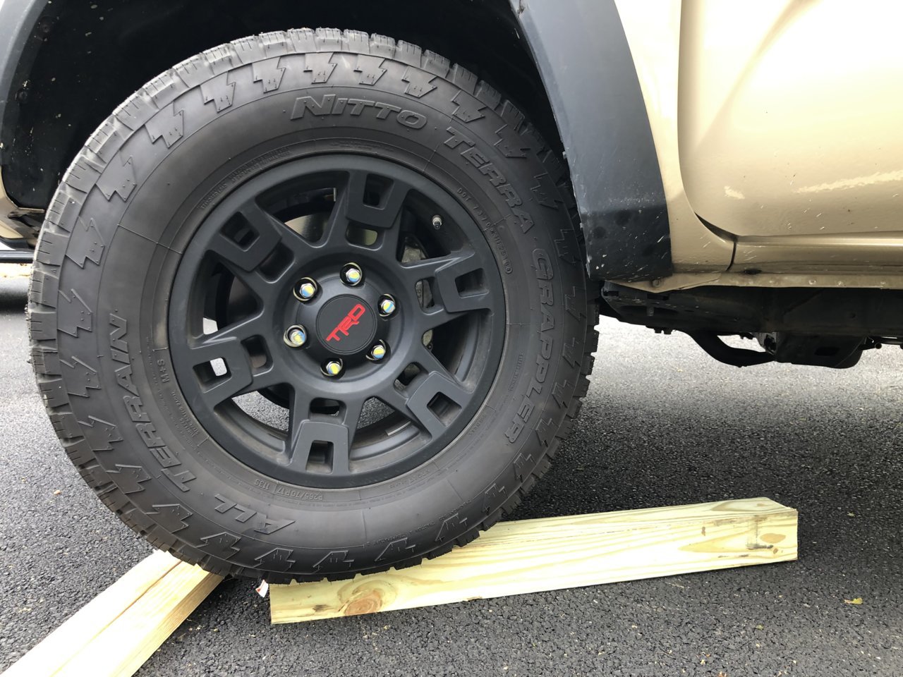

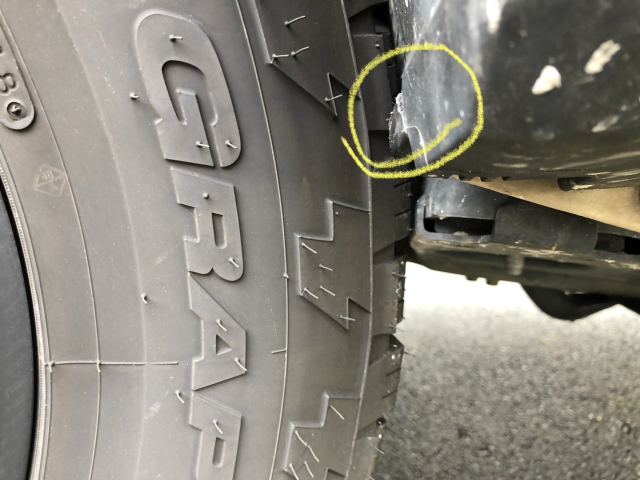

    PICTURES 8-9:
    Next, I backed the front driver side tire onto a 4x4 piece of scrap wood as a quick way to simulate a small amount of flex or going over uneven terrain. I kept the wheel turned approximately 80% to the left and as you can see the tire is now even closer to touching the cab mount. Again, I did not measure but would estimate the gap to be about the size of a sheet of paper. I am by no means an expert of very knowledgeable on this topic but would strongly suspect that if this setup was taken off road there could be rubbing issues with the tire and the cab mount.
    In conclusion, I suspect that the rubbing issue would be mitigated with the removal of the wheel spacers. In order for this setup to function as is, I would need to cut or reform the wheel well plastic which I do not think would not be a big deal. My biggest concern would be how close the tire gets to the cab mount. That leads me to believe there would be a likely need to do a cab mount chop to have full off road functionality, but I cannot confirm that.

    try it without the spacer, and report back. the trd wheels have a different offset, and set back. you dont need spacers for more "poke". Ski
