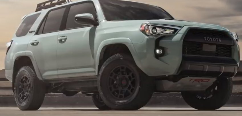

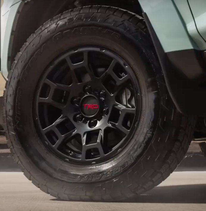

    Screen Shot 2020-07-15 at 11.11.01 PM.jpg Screen Shot 2020-07-15 at 11.11.40 PM.jpg The 17" 4Runner Pro wheels that you want have just been updated for the 2021 4Runner TRD Pro, it maybe worth your time to check it out to see if you like it more than the current.

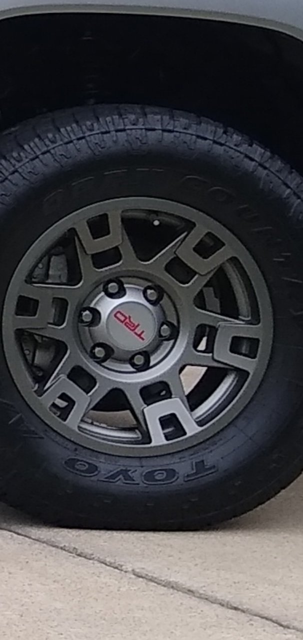

    Screenshot_20200721-082537.jpg Again, mine have 20k miles been rotated and balanced every 5k miles, perfect condition. In fact my son's wheels are in the same perfect condition. Maybe because we have gray matted finish, ceramic coating has been applied. We only use Murphy's oil soap and water to clean our wheels. It works for us.
