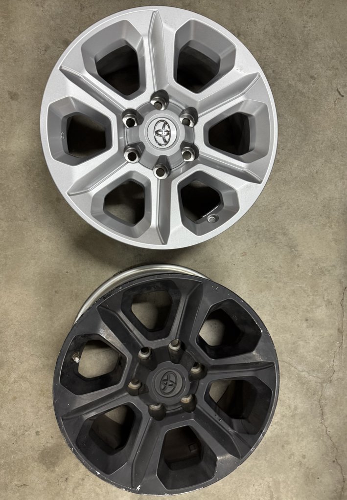

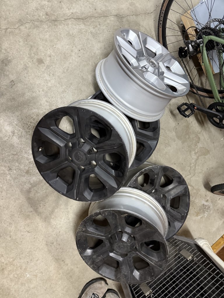

    Hello all,
    I recently bought some used 4 runner wheels off marketplace and ebay and I realized they have different machining/casting features on the back. I guess Toyota does have 2 part numbers (4261135520 and 4261135530) for this wheel design. They are the same offset, diameter, and width. I weighed them too and they weigh the same. I’m planning on going with 255-80-17 and doing a 5 tire rotation. Will they all behave the same on the road? Thanks!

    If balanced properly, you won't be able to tell any difference while driving.
