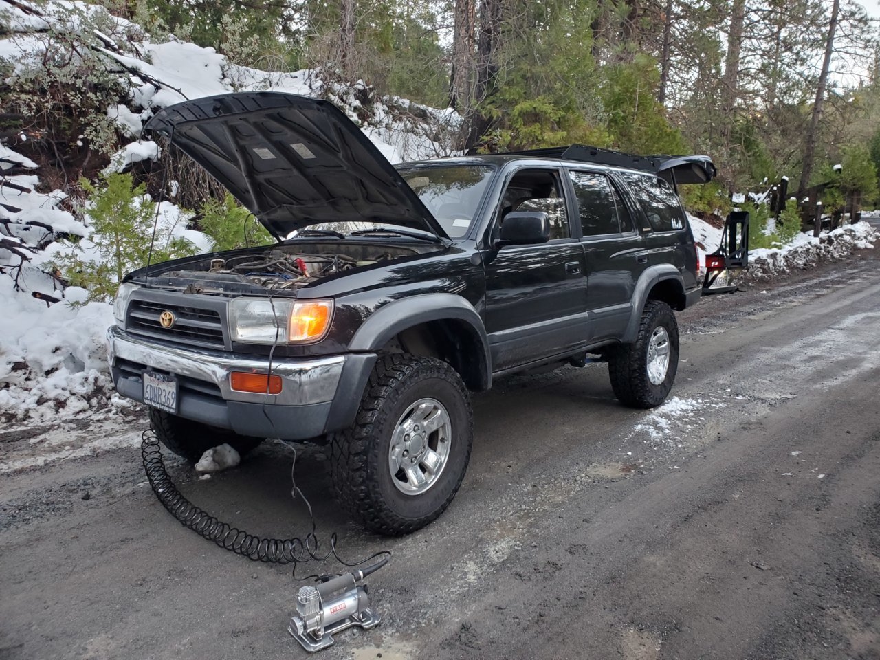

    Well, I use one all the time and it's the 400P

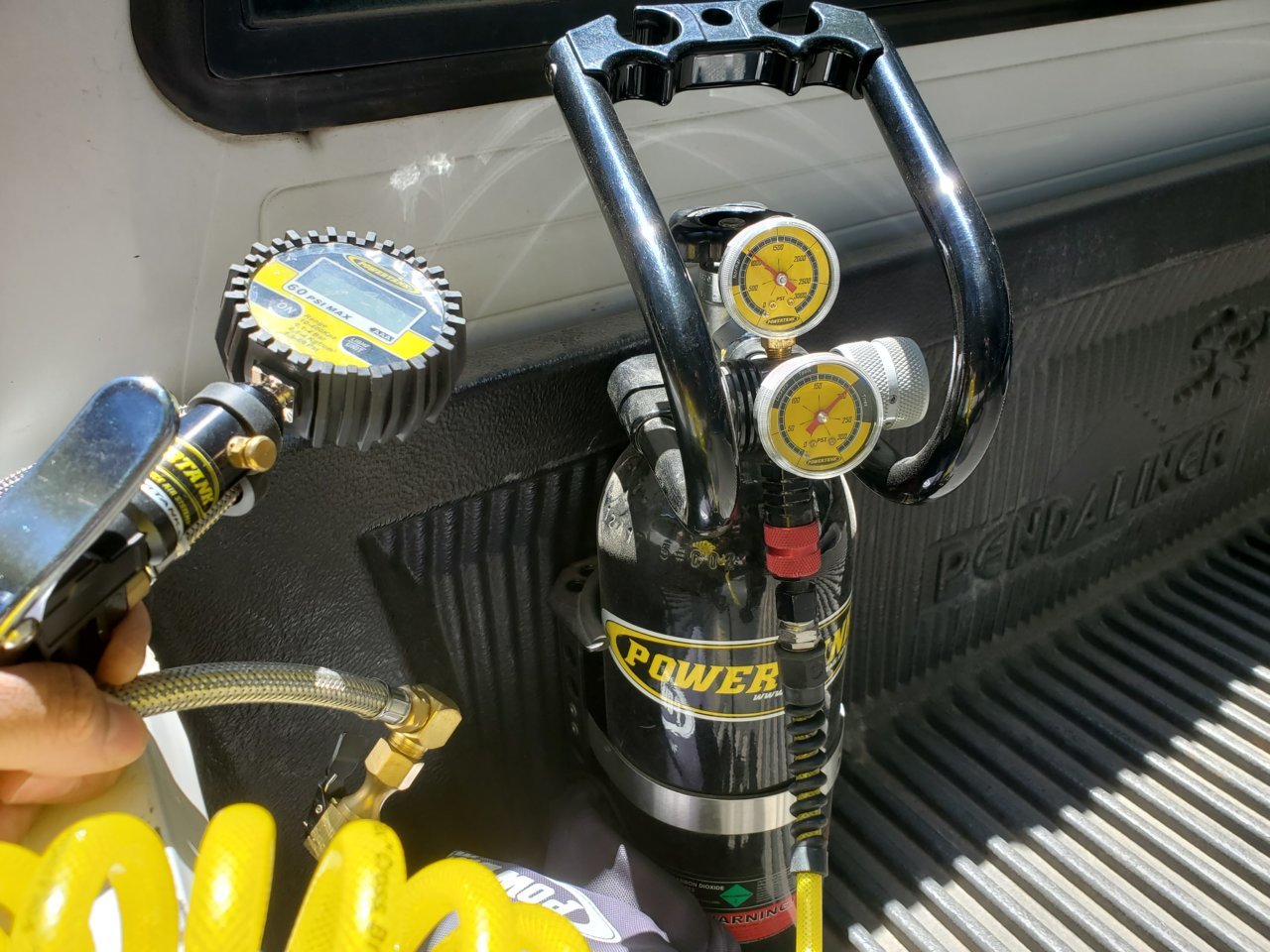

    Surprised with it really considering my first means of airing up was a Powertank using CO2
    CO2 provides such high pressure with so much volume you can easily reseat tires with it and even run power tools for a short time
    I thought I was largely downgrading when I switched to a battery-run compressor but the Viair has really impressed me

    My old setup when I used to have a Tacoma
    The setup I used with the 4Runner and now the Land Cruiser
