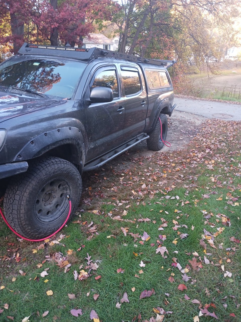

  10. Oct 23, 2022 at 12:48 PM
    #50
    amudie
    amudie Veteran Member
    Feb 21, 2016
    #178939
    189
    Andrew
    Pennsylvania
    2018 Tacoma TRD-OR DCLB
    AluCab Canopy SSO Slimline Hybrid Bumper w/ 10k winch and 20" Hiese light bar.
    This is what I have on my truck. Paired with an ARB twin compressor, this works like a dream!
