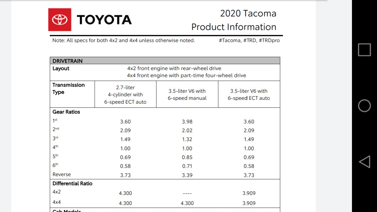

    Yep that's all that matters! All 3rd Gen V6 Automatic should be 3.91's though.

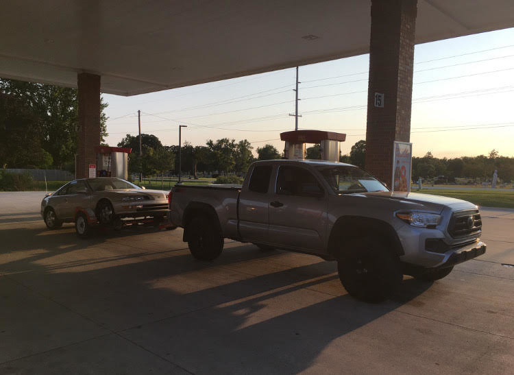

    In my opinion, pulls just fine. Not going to win any races off the line, but no issues. 3,900 lbs well over 100 miles on an Indiana freeway with traffic lights. I've also pulled enclosed trailers a few hundred miles on the freeway. Always been happy with it.Toyota Towcoma.jpg

    The consensus on TW is that 3.9 is marked as 07.
    The pumpkin label should have A7 or B7.
    A4 was used on 2015 models..
    only way to figure it out is to open one and count teeth.

    Imo, it would have been perfect if 4.10 or 4.11's.

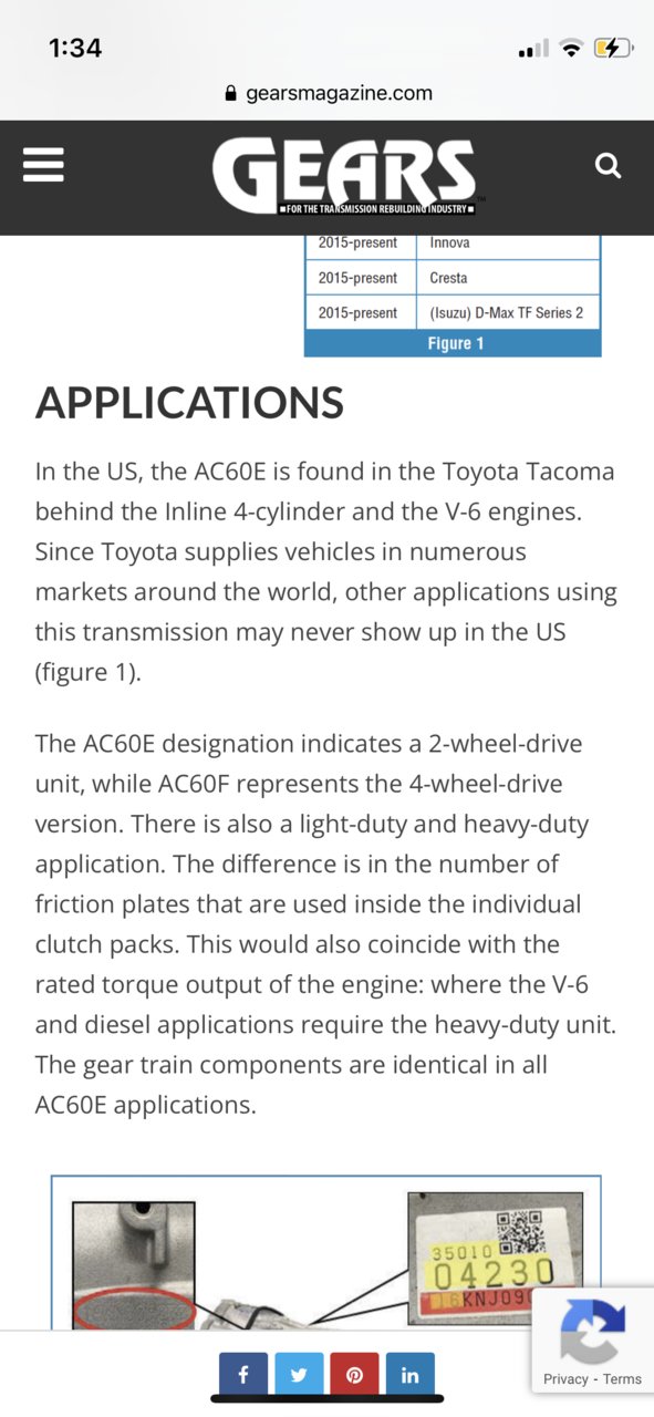

    Curious to know what makes that number different from the AC60F in my 2020 sr5?

    AC60F is the code for the Transmission, AC60E would be the 2 wheel drive version.

    Don't think that's a gear ratio code.
    shakerhood is a knowledgeable guy & he's likely correct.
