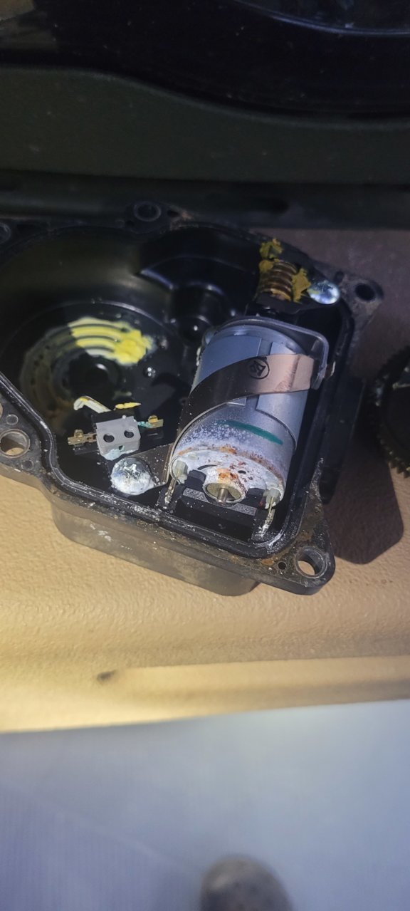

    Took my ADD off and it was heavily corroded, looks as if moisture got inside the module and got to the solenoid. Truck is a 10 with 145,000. Honest I aint mad. Luckily I have a complete spare front diff and was able to pull the ADD off that one. It looks brand new on the inside and the 4 wheel drive works again.
