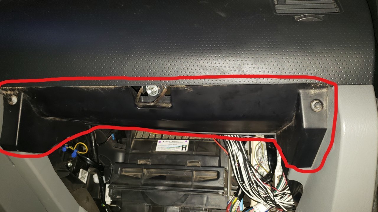

    Thank you for this! However, are we talking about a 2nd generation Tacoma? The color scheme doesn't coincide. Like I don't see a blue/yellow wire or red/blue wire. Then the voltages I'm getting are nowhere near what the chart says I should be getting on the wires that I can read.

    Yes, this is for the 2nd Gen trucks.
    Are you sure you are looking at the 4WD ECU?
    You have to remove 1 bolt and take the panel down.

    Yes Tn, I did remove the panel and the wires look similar. Just not seeing some of the colors.
