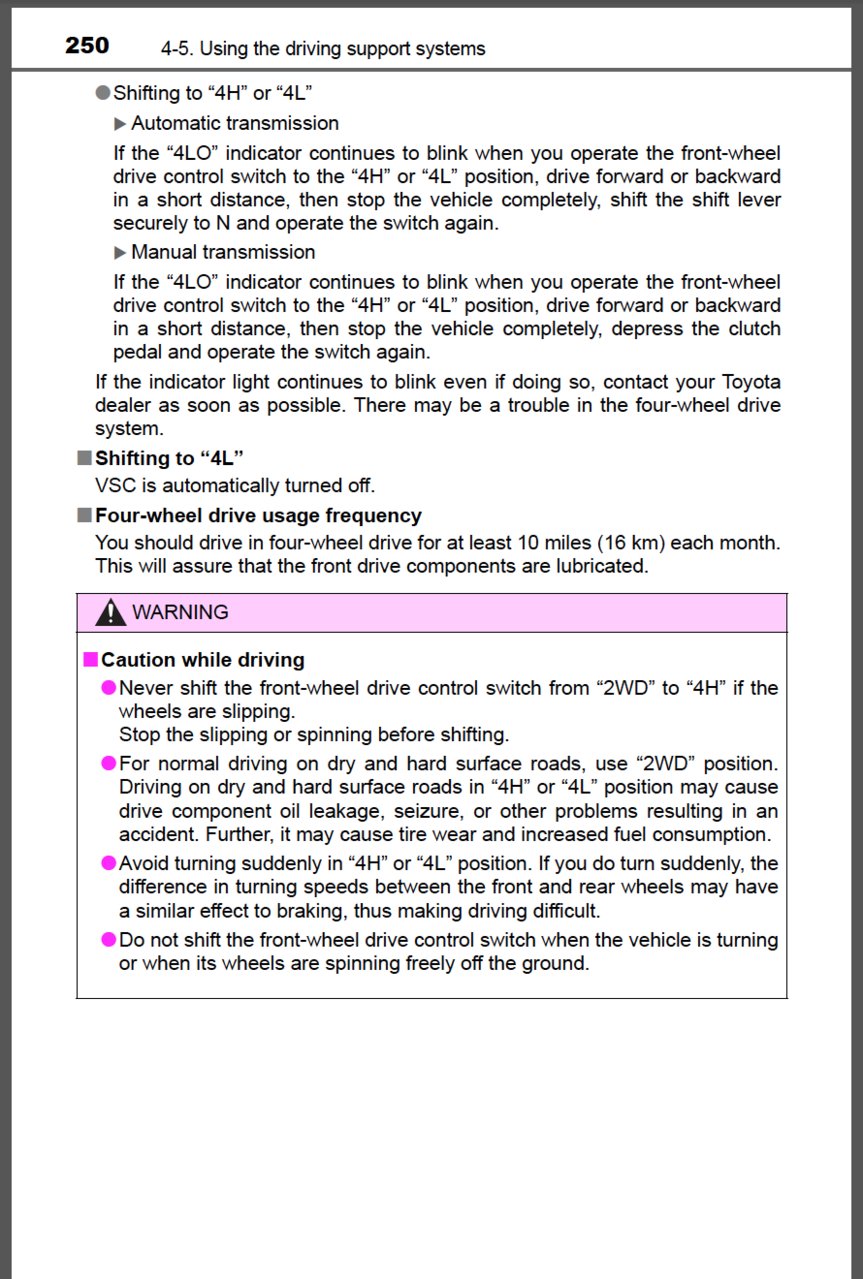

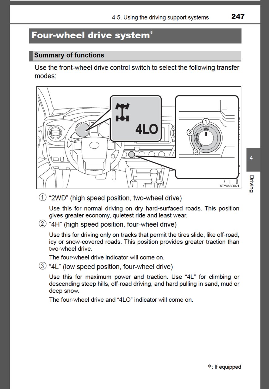

    I agree with the traction control guesses. Perfectly normal sound, although disconcerting the first time you hear it. Also agree with the advice to generally not drive on dry pavement in 4hi or 4lo:

    I know everyone says turning in 4hi on dry pavement is very bad, but what about 4lo? Similar issue?
  19. Mar 7, 2018 at 12:33 PM
    #19
    fredgoodsell
    fredgoodsell Well-Known Member
    Jan 14, 2015
    #146389
    2,158
    Salt Lake, UT
    2017 DC TRD OR
    Same problem. Probably much easier to actually damage things doing it in 4lo.
  20. Mar 7, 2018 at 12:34 PM
    #20
    strktly_bodysurf
    strktly_bodysurf Well-Known Member
    Jan 4, 2018
    #240209
    983
    So even off roading you're supposed to avoid total lock out situations, or potentially run into broken cv joints if you randomly have full traction on all 4 wheels?
