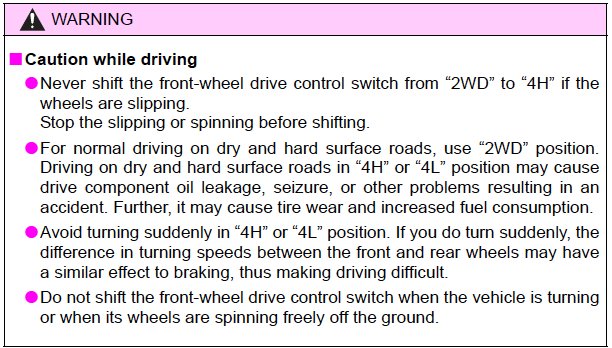

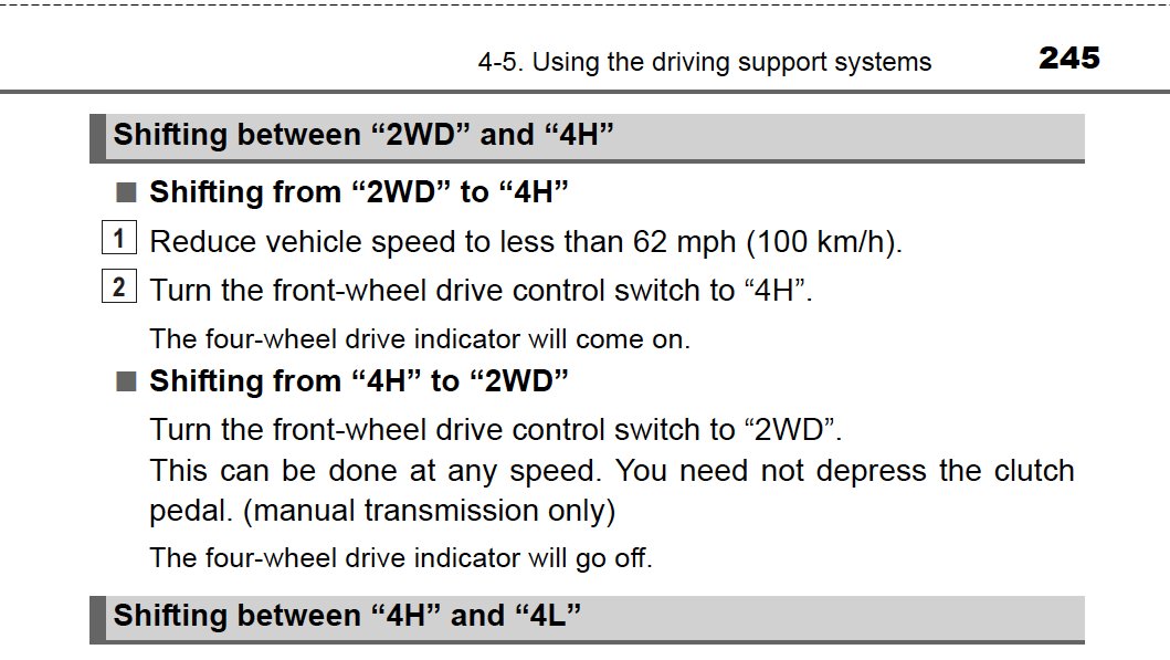

    Hope this helps

    Awesome thank you very much!

    You can't go into 4lo on the fly

    You can go into 4 hi while moving and in D. You just need to be off the gas. 4 Lo is a different ball game.

    What are you talking about? Neutral is not necessary in order to engage 4wd Hi.

    Realistically u shouldn’t use 4x4 for on paved roads unless the conditions are extreme and you are not making extreme turns . The system was not designed for paved roads like a awd system . If u read in the manual it has a big warning using it on paved roads . Can cause potential damage .
