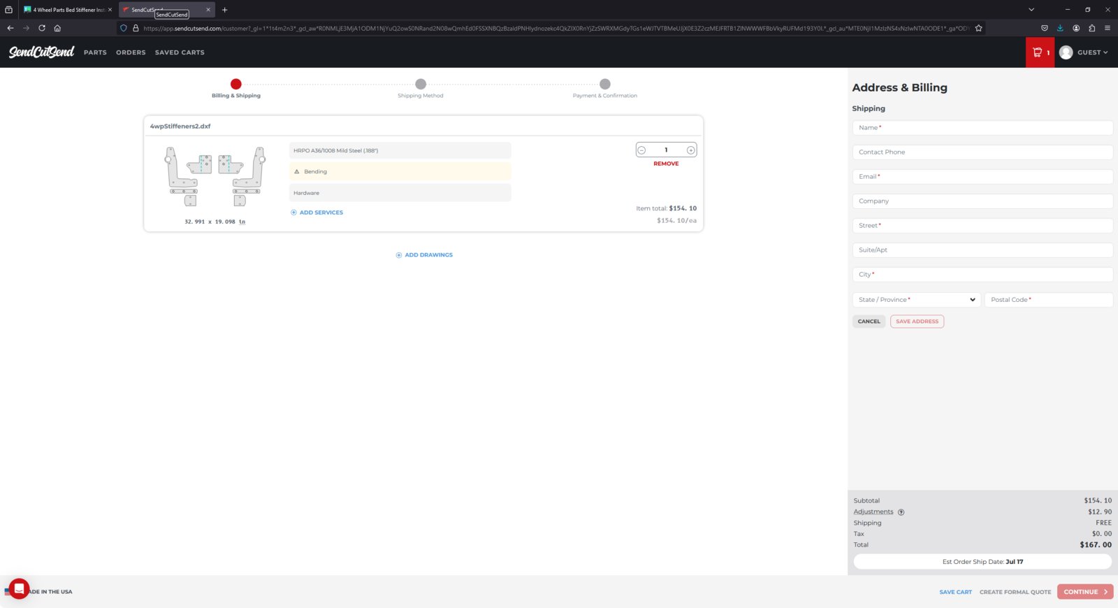

    I should clarify, if anyone orders via send cut, they would also still need to weld nuts on.
    I guess you could do w.o welding but it might be trickier.
