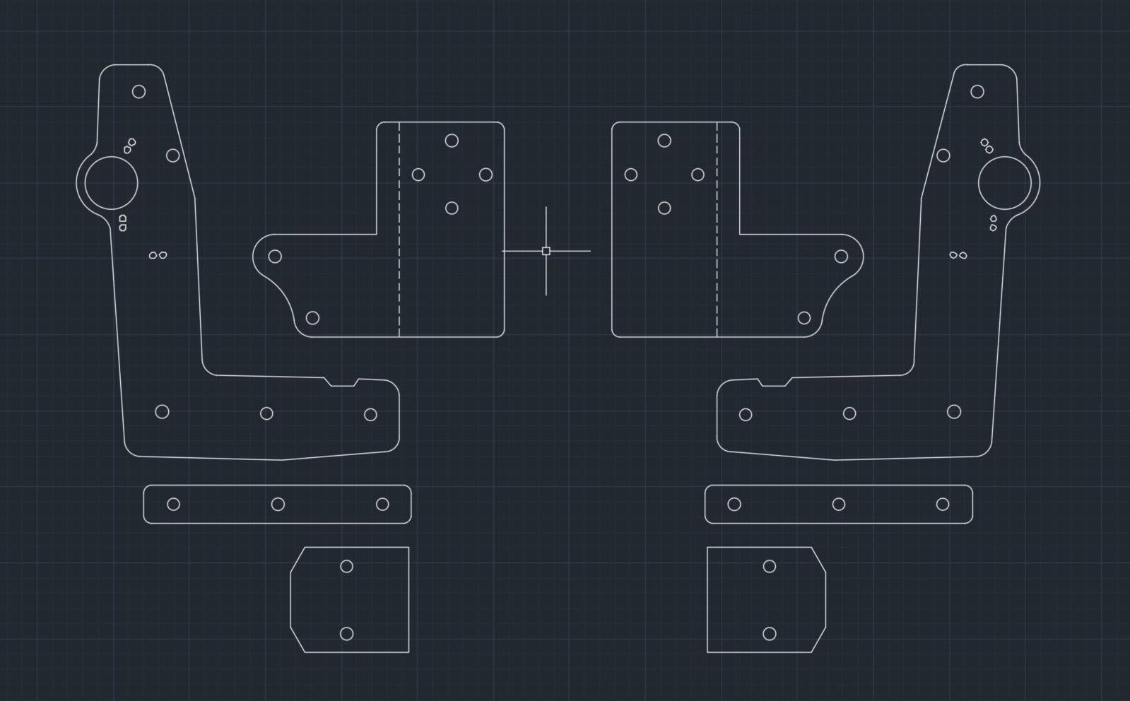

    Ok so I did some measuring, scaled the image on 4wp as close as I can and made a dxf drawing the closest I think I can do.
    The only inaccurate part is the exact angle of the OEM holes the stiffeners are supposed to line up with, and making sure all the parts sit perfectly level.
    I can figure it out by making some templates but I would have to drill out my truck bed to get the holes in the right place.
    I'm not sure if I want to do that unless someone is for sure down to make this... Kwikvette ??
    I don't want to use OshCut / SendCutSend - it would be super expensive.
    And also the nuts still have to be welded on
    One more detail I haven't incorporated is the sheet metal thickness. What is an appropriate thickness for this?
    I can add the correct line for the bend once I know the thickness.

    I'll open it up and cut one side out tomorrow (er later today)
    If I cut it in 16 gauge as a mock up, I'd love to send it to you for test fitting
