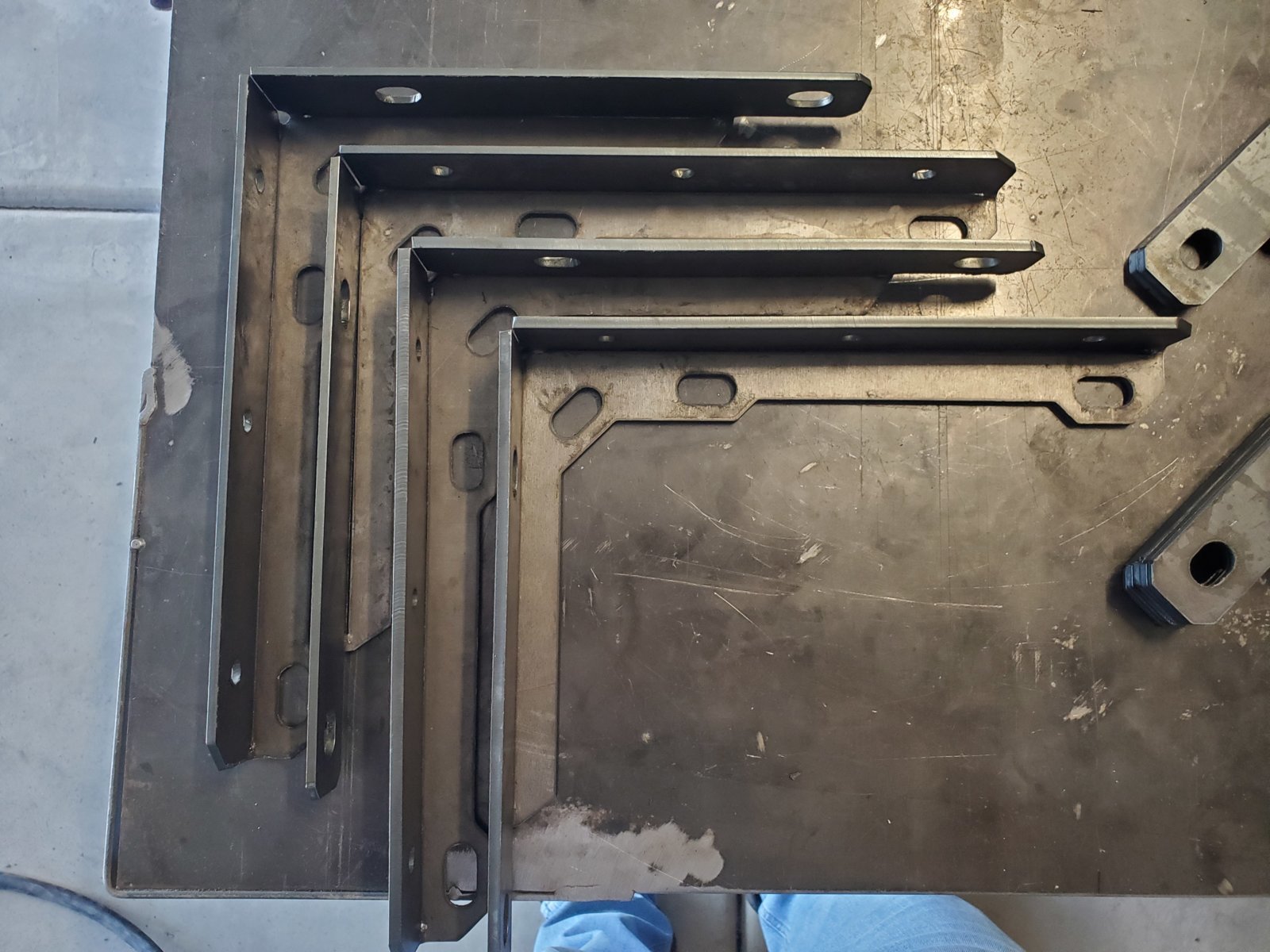

    On another note, is there a 3rd Genner in the Central Valley (CA) that would be interested in helping me mock-up?
    Just need the truck (you can chill, enjoy a beer, talk shop) while I use pre-cut parts for my own measuring.
    This way I can easily figure out the placement of the nuts to be welded (how detrimental the spacing is).

    That's 12 gauge
    I'd consider it pretty thin for this application, although maybe I just need to get my hands on it when installed
    I would've thought this set would be better made in 11 gauge as it's thicker (.125) and very popular in general
    3/16" is commonly used for standard bed stiffeners although I've used both 3/16" and 10 gauge
    (3/16" shown here)
    Stevie17 likes this.

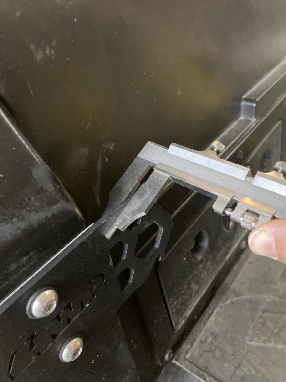

    Based on @Captqc caliper's, I'd say that exterior part is 8 gauge (thinner than 3/16")
    That's just my best guess since powder coat adds a bit of thickness and I don't know how thick that coating is and even then it's thinner than 7 gauge
    Don't know if the inner pieces are the same thickness or not but I'd venture to guess they are
