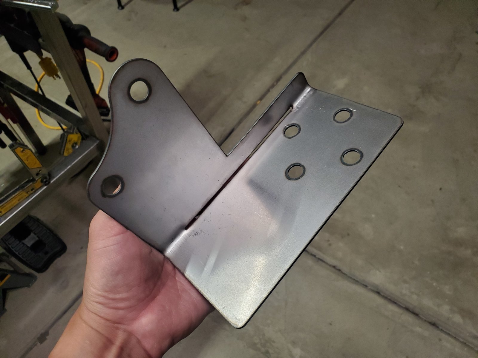

    The relief cut I incorporated was so that anyone can bend this on a table's edge
    This wouldn't be the case for the finished product though as it'd be much thicker
    I did get rid of my press, and although I do still have the brake fixture itself, I won't have a means of bending metal
    So for the actual product, I will most likely buy a small setup just for small jobs like this one
    Tools require money right :spending:
    We'll see how it pans out though, we're still pre-mock up!

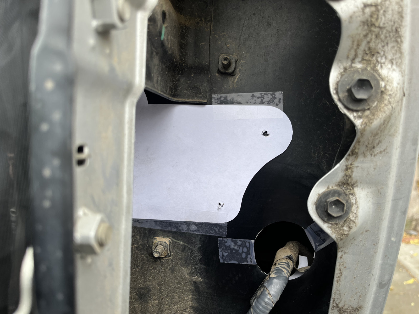

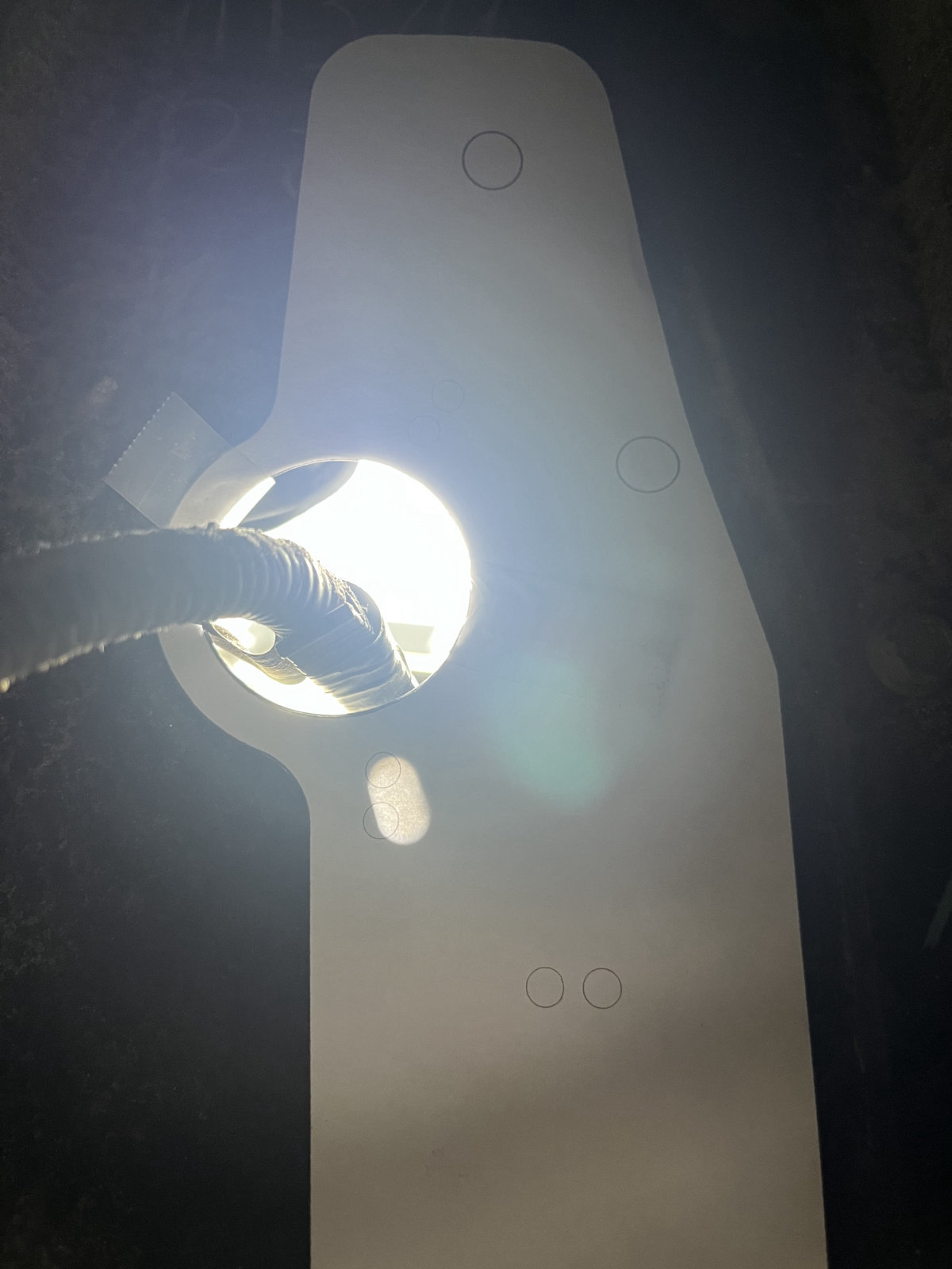

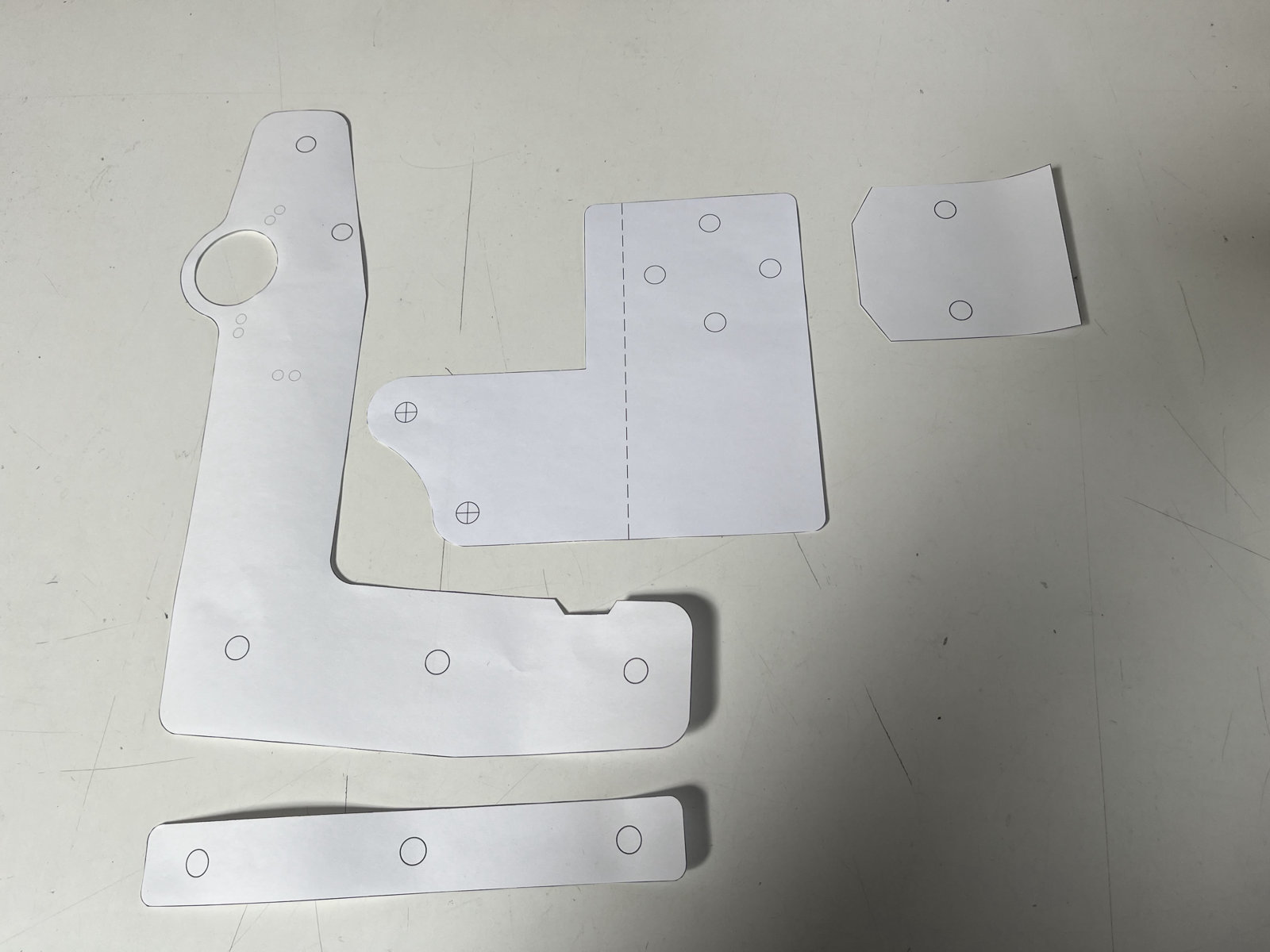

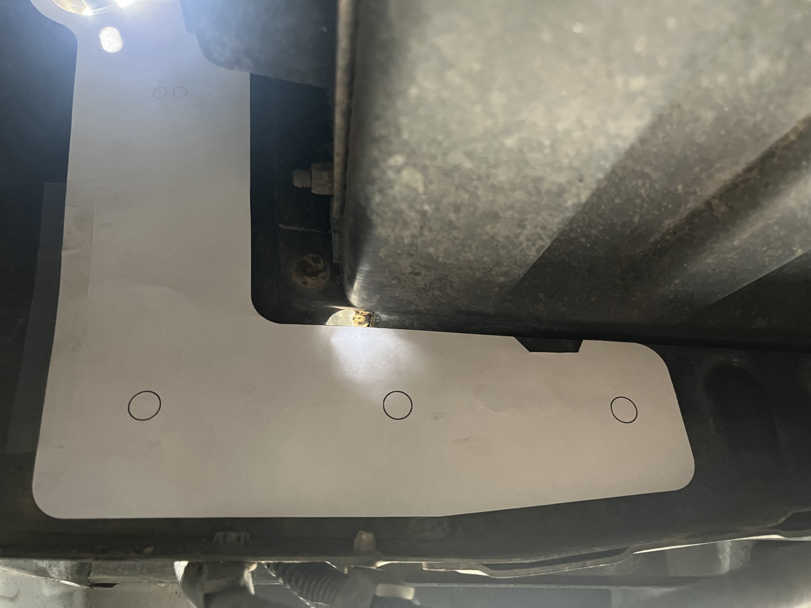

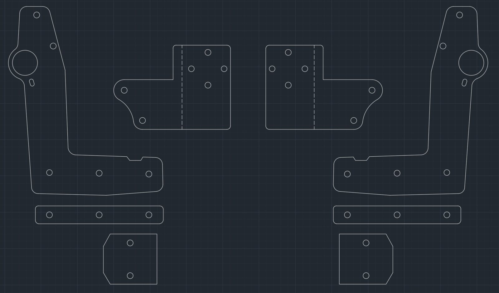

    IMG_9981.jpg IMG_9982.HEIC.jpg IMG_9983.HEIC.jpg IMG_9984.HEIC.jpg IMG_9986.HEIC.jpg Screenshot 2024-07-09 at 6.32.22 PM.png
    Ok paper templating went surprisingly well. The main L piece fit pretty well as is.
    I lined it up to the truck as well as I could and drilled tiny holes to mark where the pieces will mate together.
    Then I went back to the computer and lined up the template to put the marks in CAD.
    Most of the holes were close but it's way more accurate now.
    The original corner bracket holes I drew were way too high. It went up into the curved part of the bed. So that piece is shorter now.
    The only thing I'm missing is two additional slots for those plastic cable guide things. I think they're on the 2.5 or 3rd gen.
    I have a 2nd gen and my truck doesn't have them.
    If someone wants those added, they can trace the holes on paper like I did and mail it to me. Then I can add it to the CAD.
    Beyond that, I'm pretty confident this will fit my truck as is. So Kwikvette if you want to cut it out, I can test it.
    I based the bend line on 10 gauge (0.135") steel, using the SendCutSend bend calculator.
    The drawing will change if a different thickness is used.
    Updated CAD file is attached

    I'll have to give you my email so I can get a dxf unless you can post a zip here?
    As for slots, I've got a 3rd Gen coming by this Saturday
  13. Jul 9, 2024 at 6:58 PM

    DXF zipped and attached!

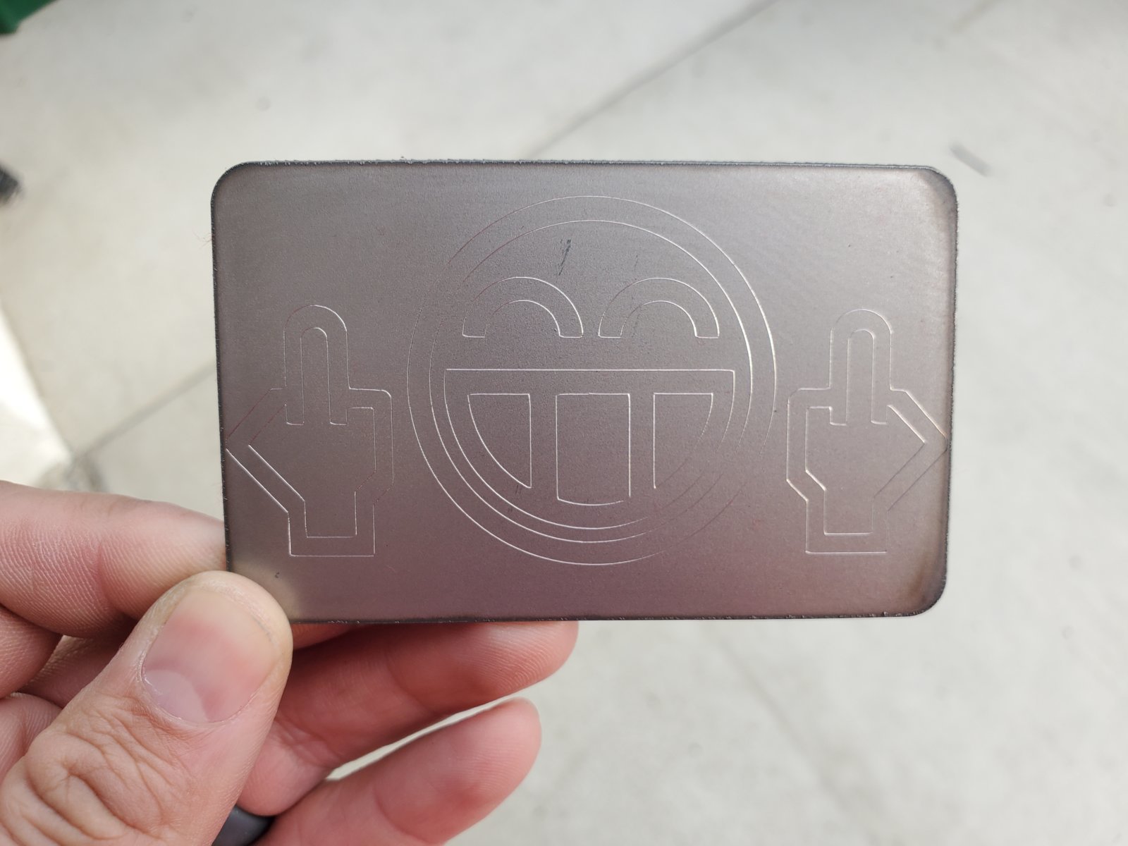

    Small example; this was my first test piece...but also my last :anonymous:

    Tie down point, bottle opener, and an F-bomb!

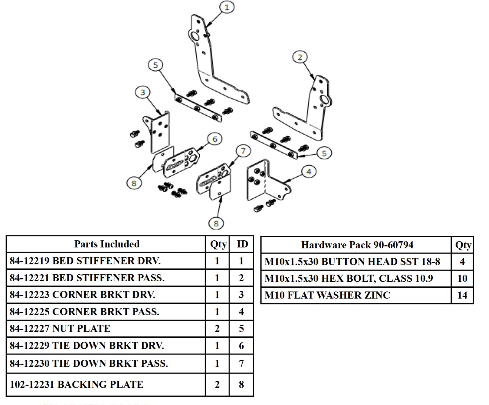

    Ok, looking at the install instructions again (but sober)
    Now I see that the short, two-hole plate, is the exterior piece
    This means that only two of the four holes on the inside bracket are used since two are for a vertical install and two are for a horizontal install
    I will really need to make a new thread to gauge how many would prefer a vertical install and how many would prefer a horizontal install
    Why? To utilize less hardware overall (welded to the inner mounting bracket)
    Secondly, I could make the outside piece specific to the install orientation by incorporating a tie down and if desired...a logo in the correct orientation
