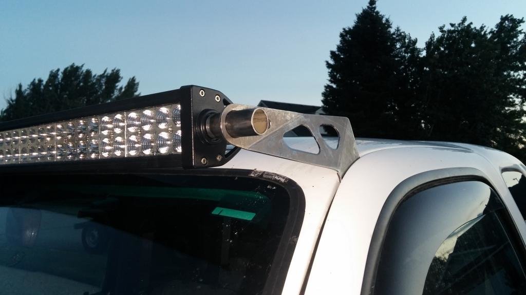

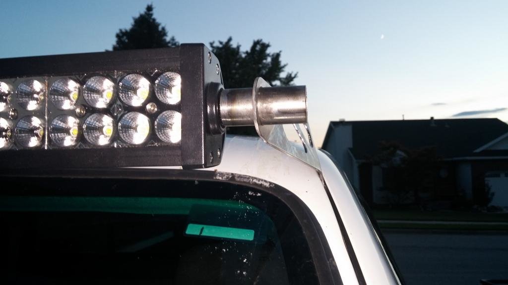

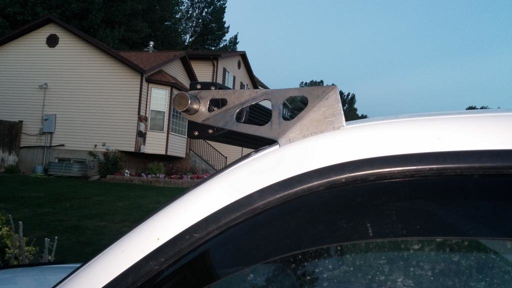

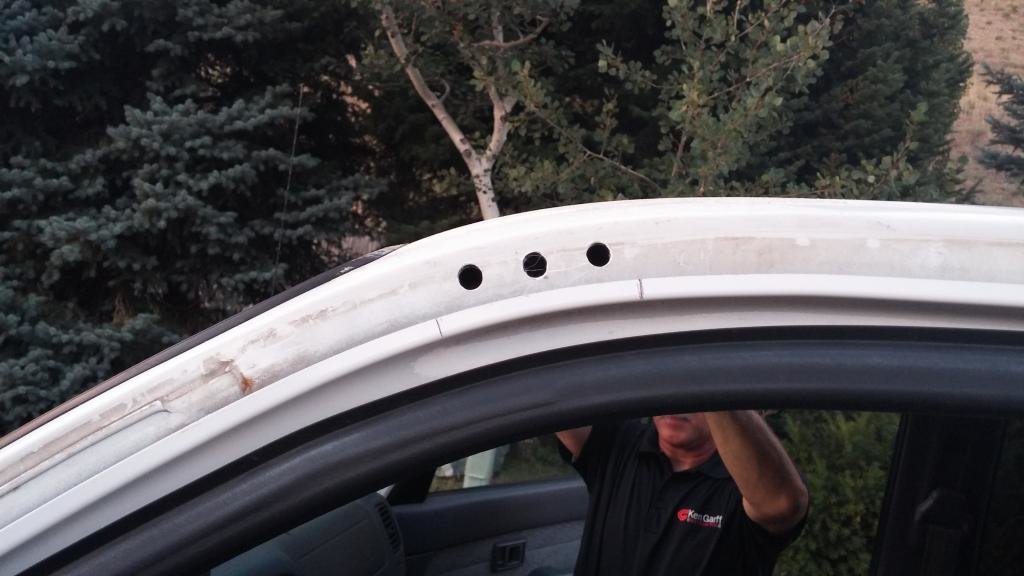

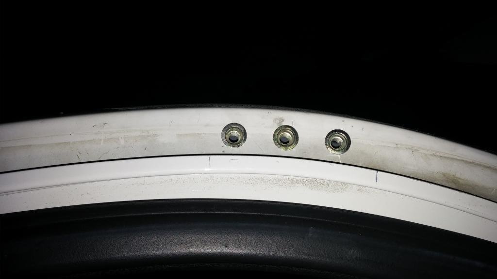

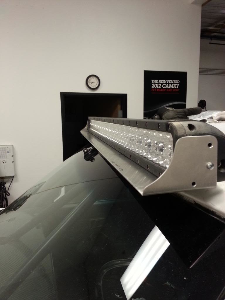

    Around the start of April I ordered a 40" light bar that ended up being 41.75" for my 99 Tacoma. And after searching I noticed there wasn't that many options for mounts so I decided to make my own and this is what I came out with. It uses 3nut-serts and screws in each mount to mount in the small channel behind the doors. The mounts should accommodate between a 40" to a 44" light bar seeing as different manufacturers arn't all the exact same. please feel free to leave feed back or any ideas to improve the design.
    I currently have 2 more sets that could be made.

    Another question, is there any flex in them or are they pretty stout?

    Once I had the light bar mounted it wasn't moving when I was pulling on them (the tubes arnt welded on yet which will be an option when buying them) they are made out of 14 gauge so I doubt they are ever gonna flex much.
    And the light a just a cheapo Chinese brand I bought for mock up and to use till I can afford a rigid.
    The light I used is 41 3/4" wide (mounting surface to mounting surface) but I can make them to fit up to 44 inches or I can send them unwelded so you can do the size yourself. I'm currently working in a deal for powdercoating so that may be an option too, but we will see.

    Dude I've never seen those nut serts. How do they work? I did basically the same thing but I ended up putting nylocks on the inside under the headliner. Was a total bitch!!! Wished I knew about those earlier:)

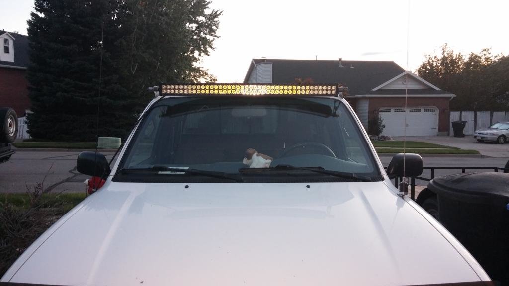

    do you find there is light on the windshield? Mine gives a slight glare in nearly the same location. I noticed it when the dust on my windshield became visible lol. I know its pretty common regardless of light brand. A guy on dezrangers ended up making a little visor for the bottom of the light bar as a solution.

    There didn't seem to be any glare from the light when I tired it out but I also havn't had it in a dusty area yet, though the light seems to hit just at the bottom of the windshield.
