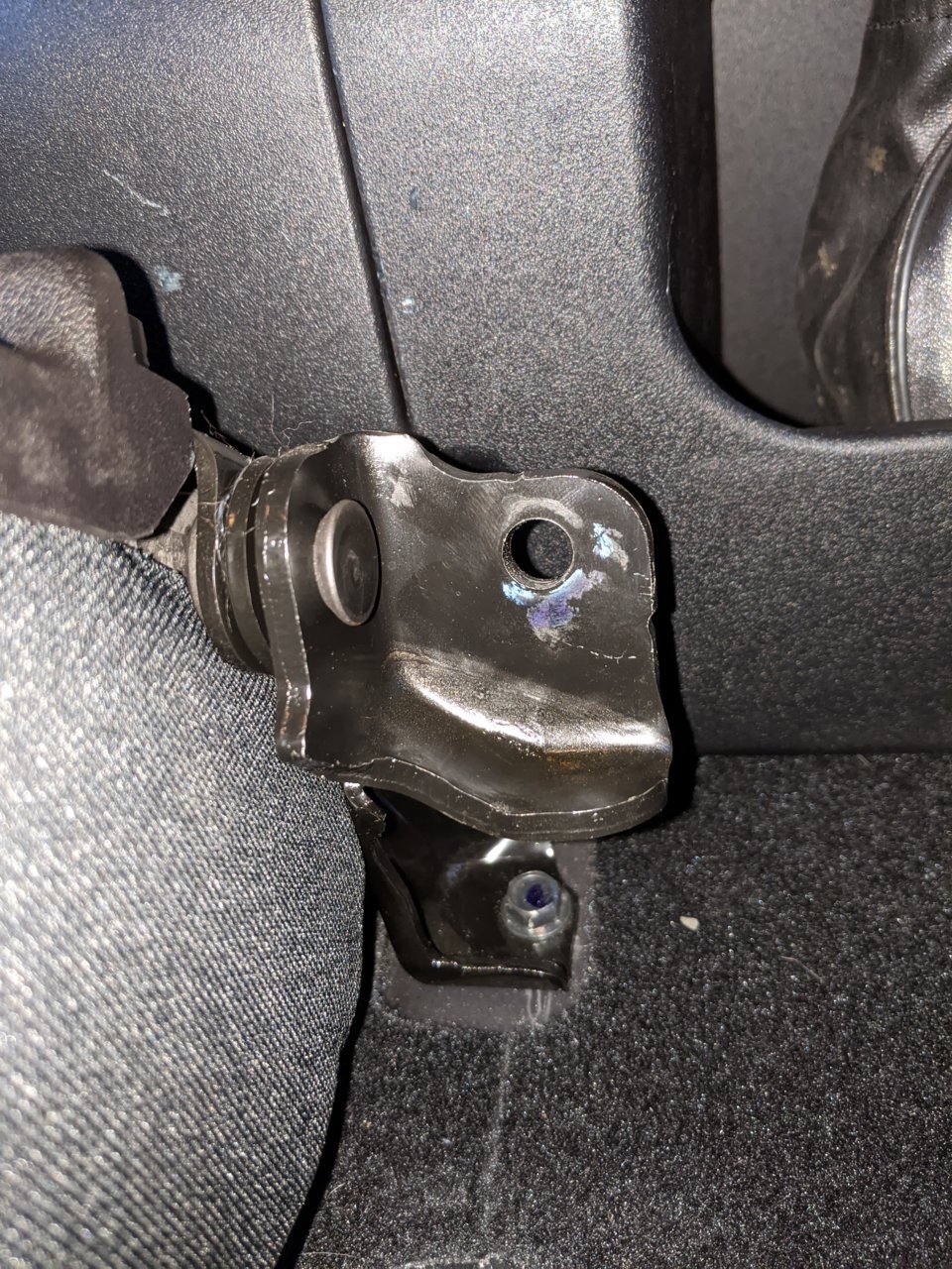

    I am working on removing the driver's side rear seat. Can anyone give me some advice on how to remove the bracket used to attach the seat back where is pivots along the 60% (passenger side ) section? I am leaving the 60% in the truck.
    Thanks.

    I don’t think there’s an easy way to split it. It’s been a while since I took mine out, can you swap the outside one to there?
    otherwise you probably have to chop it off and replace it with a bolt.

    Yeah, that part doesnt come off. You could remove that whole piece where its bolted down and see if the single on from the other side fits in the holes.

    That center bracket is for both sides and unfortunately the pin/bolt is captured. So like Shellshock said you would have to cut it and then replace it with a nut and bolt.
