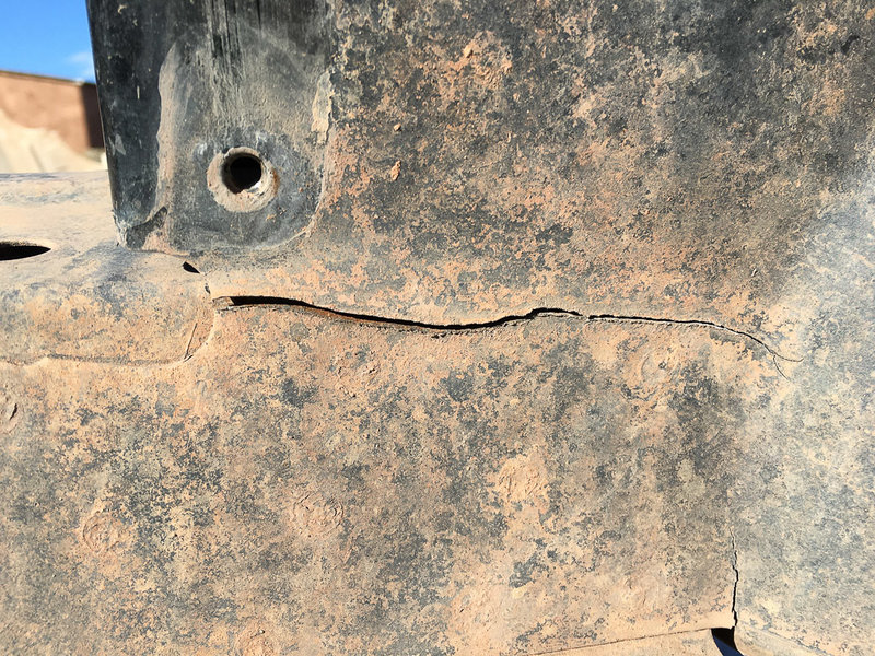

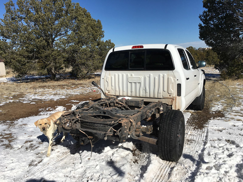

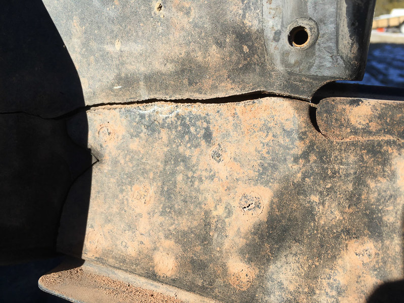

    Popped the bed off to weld a crack in a sheet metal bed support. I am thinking that while the bed is off this may be the time to replace the fuel pump and filter.

    How on earth did you find a crack underneath the bed? Did you just hear a funny noise and thought "I think that sounds like a crack in the sheet metal bed support?"

    2006 & 2016 DCSB TRD Off Road 6-Speed
    The bed looked like it vibrated more than usual on one side.

    Where exactly is the crack located? Have you given any thought to replacing the bed with the Ute bed?
    Crack is on the black cross-sill that ties rear of bed sides to box and forms the bed side of the latches for the tailgate. Item #3 in diagram. I don't want to buy a replacement at that price , so hopefully a friend can repair it by welding.
    Cracked on the forward corner of both sides as it turns out. Lots of flexing of the frame while wheeling, the bed has to flex in response and I guess after 400k this is a weak link.
