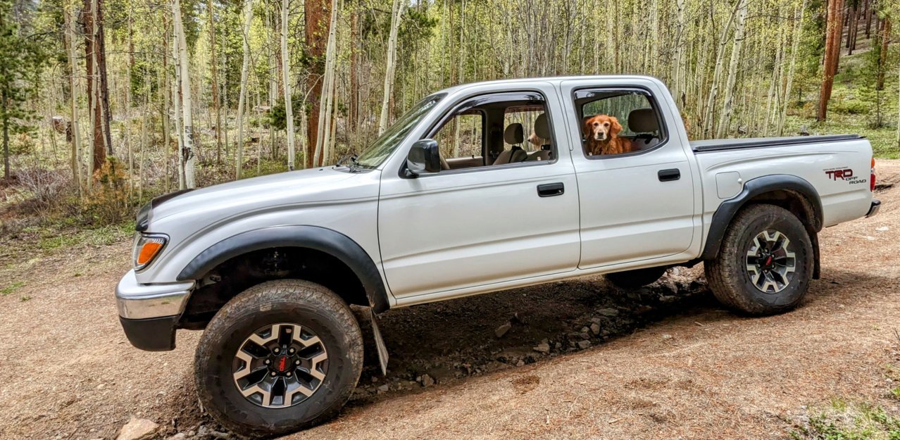

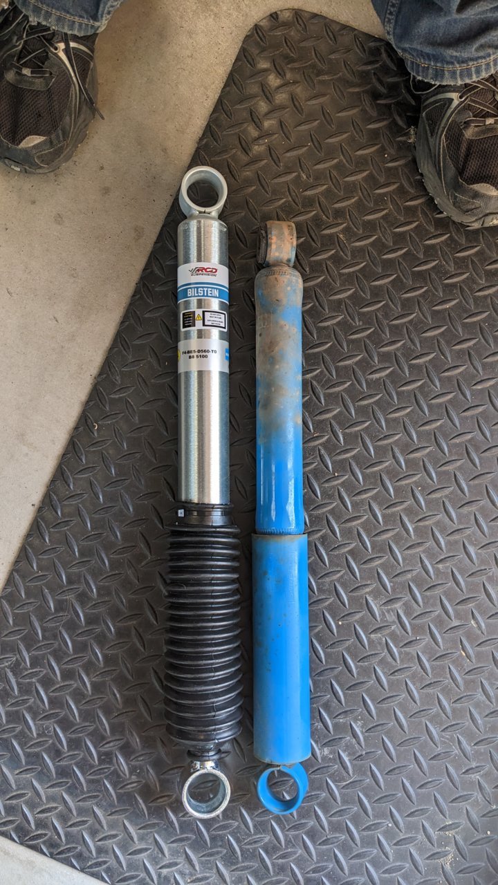

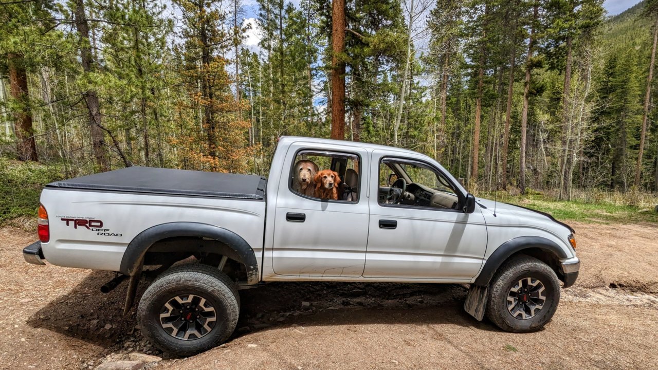

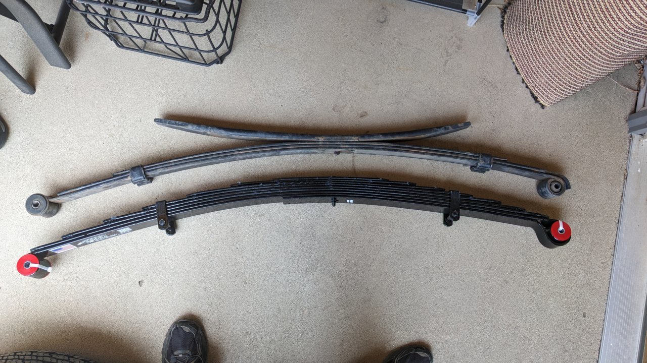

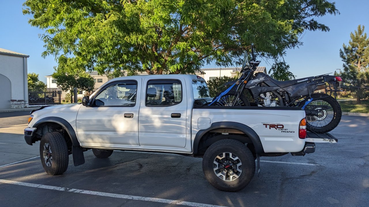

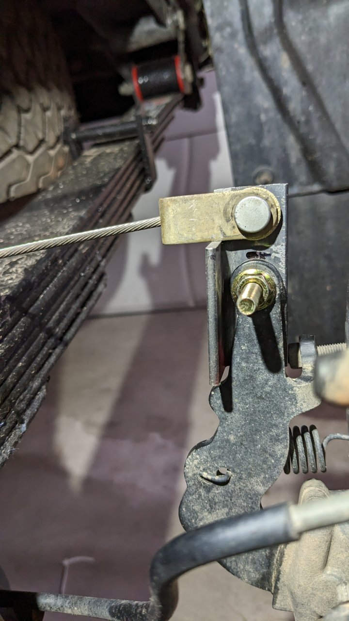

    I got the 6200s installed as well as the Alcan Springs. Install was pretty straightforward. Except I wish I had thought to grease the shackles. Squeaky buggers now. I did end up going with the +100 springs and am feeling some anxiety wishing I gone with the +400. They do feel fairly stout though. I'll have to load em up and just see how they do and go from there.
    Here are a few pics.
    I will add a good b&a with measurements later on PXL_20230607_191843218~2.jpg PXL_20230607_191923503~2.jpg PXL_20230603_182826606.jpg PXL_20230521_231440764.jpg PXL_20230521_194450337.jpg

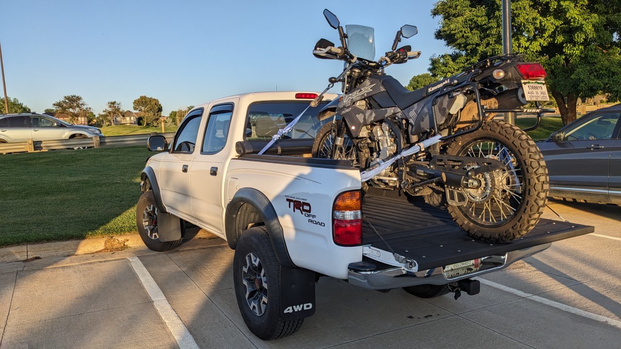

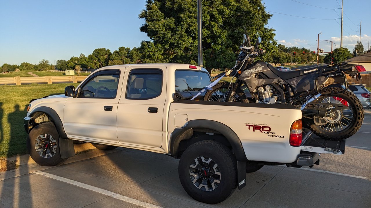

    Loaded the 300 pound KLX. The truck handled this fine. Maybe 3/4" inch drop in the rear. I didn't get a chance to measure. So not bad, I still might want to look into adding a leaf, as nothing else was in the truck. Some gear will weight it down more I imagine PXL_20230628_015824288.jpg PXL_20230628_015726629.jpg PXL_20230628_010751760.jpg
