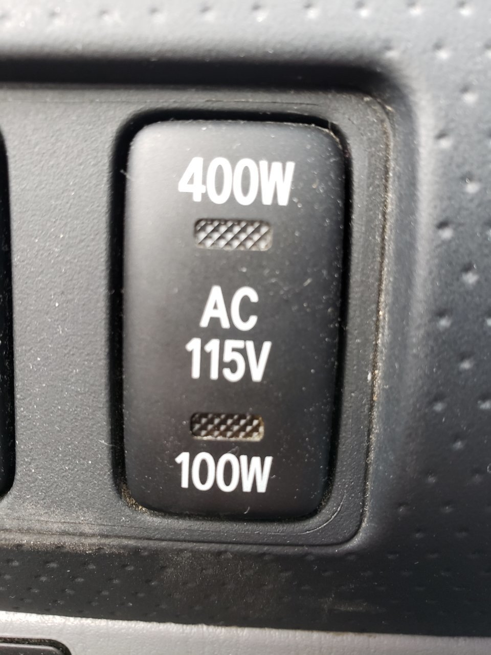

    I am at a loss. Please someone help me to diagnose why my inverter no longer works. When I push the button it doesn't work. The little lights in the button (green top, orange bottom) turn on when button is pushed, but they quickly turn back off. If I hold the button in they will stay lit for 3 seconds and then go dark. Not sure where to start diagnostics. I have checked relative fuses, but thats as far as my diagnostics have gone.
    Any ideas or experiences with why thus system fails would be helpful.
    Best regards, Justin
