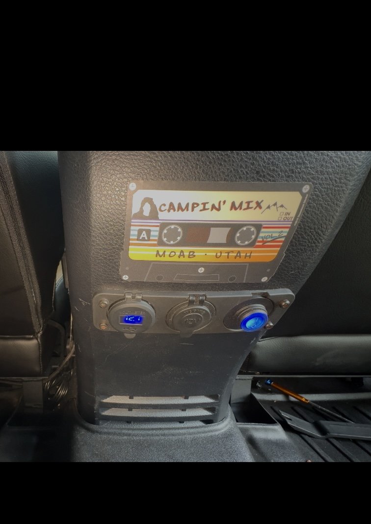

    Everything working now - got this on Amazon
    https://www.amazon.com/gp/product/B07ZJ9D231
    Has 2 tamper proof receptacles and USB A and C - I just cut a hole to size centered and didn't use the wall plate - doesn't look out of place at all, will find and edit picture in tomorrow
    Lets me charge anything I will ever have a cable for

    Why would you want to use the inverter to make power for a USB C outlet? Turning 12v to 110, back to 5-20v is really inefficient. Just wiring a usb-c port to your trucks 12v would be much better.

    Here are a couple ideas for you for the future incase you change your set up.
    400 watt anytime from Guild Outfitters with a factory plug.
    https://youtu.be/AzOr_FG7ZT4?si=jAQIat8zFAk5gvF0
    And using the center console with this panel installed gets you 12v and USB/USBC to the rear. Really like how it can be turned off/on when needed. It is simply wired to the 12v in the center console so it only has power when the truck is on.
    https://amzn.to/3I09ab4
