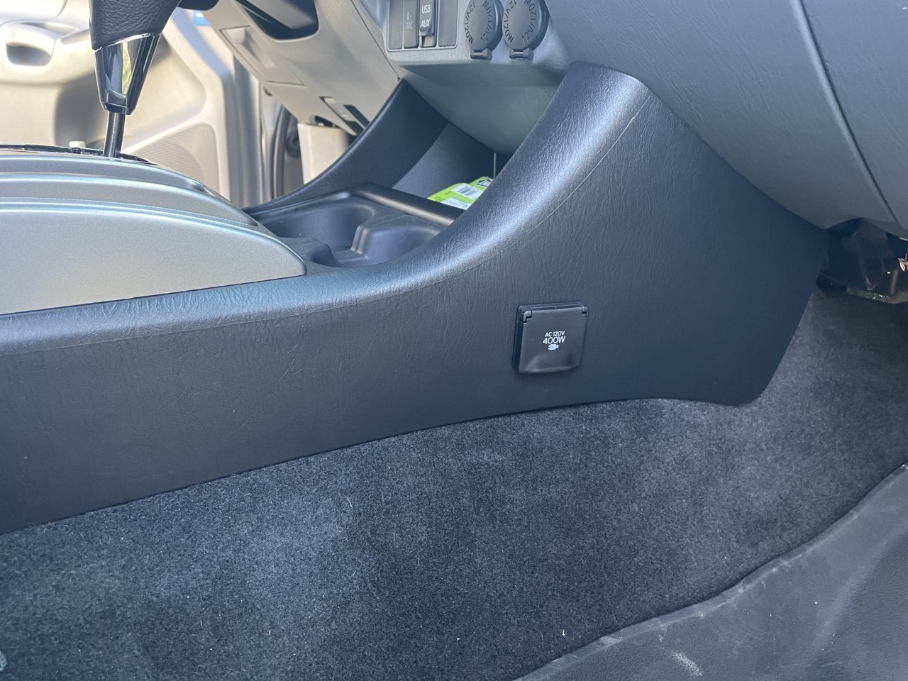

    B2ECDF38-71EA-4EF4-B4E9-85A7B57339B3.jpg Installed mine today. Everything was plug and play. Works like a charm. The plastic isn’t thick enough for the outlet to fit tight. A little bead of hot glue around the inside made it solid as a rock.

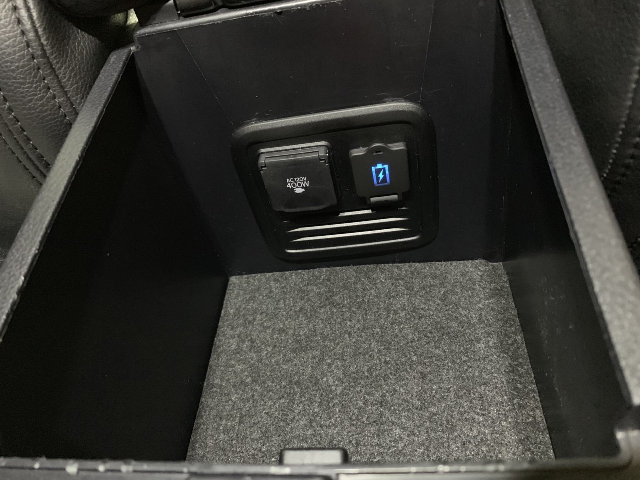

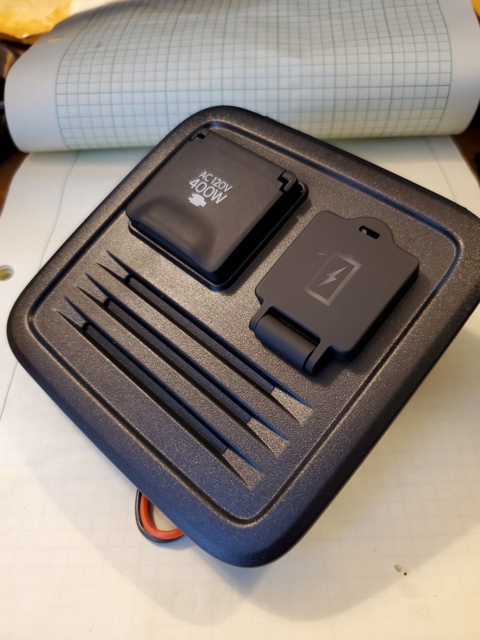

    The AC outlet is definitely made to lock into a thicker panel (no calipers needed). A 3D printed insert modeled after the hole in the T4R bezel would be a good option for a smaller footprint.
    I've pretty much decided on this setup to be installed inside the back of the center console. That bezel is designed for a thinner panel and has a spot designed for the AC outlet with thicker sides where the clips are.
    None of this is possible without the awesome harness that you offer. :thumbsup:
    Bezel is P/N 85536-35020, USB is P/N 00016-00225 (SW toyota part kit), A/C plug is 85530-35050-CO

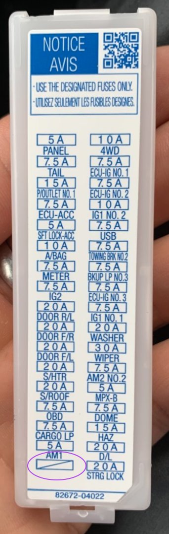

    It's definitely cleaner if you use the bezel -- that's how I originally thought we'd sell it. I explored trying to make a plug-and-play add-on for the USB plug in there but all I could think was to plug it into the the cigarette lighter wires and unfortunately there aren't any mating connectors for it. What you could do is use a fuse tap on the hot side and run it to the always-hot slot on the cab fuse panel. There's an empty one on almost all 3rd Gens and I believe it's rated for 20A if I remember @caribe makaira? It's empty, so you theoretically shouldn't be disturbing much. I'm not sure if that's the version that has a backlight, so maybe choose something with keyed power instead.
    Ground it using a ring terminal on the bolt you're using to ground the main harness. I considered fancy stackable ring terminals for modularity but ditched it at the last minute. Coulda shoulda woulda.
