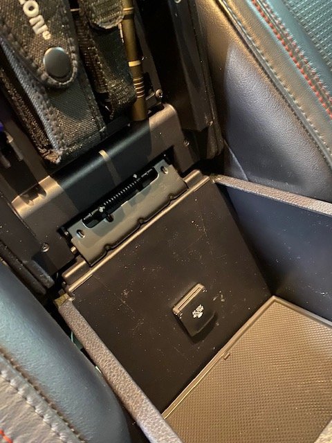

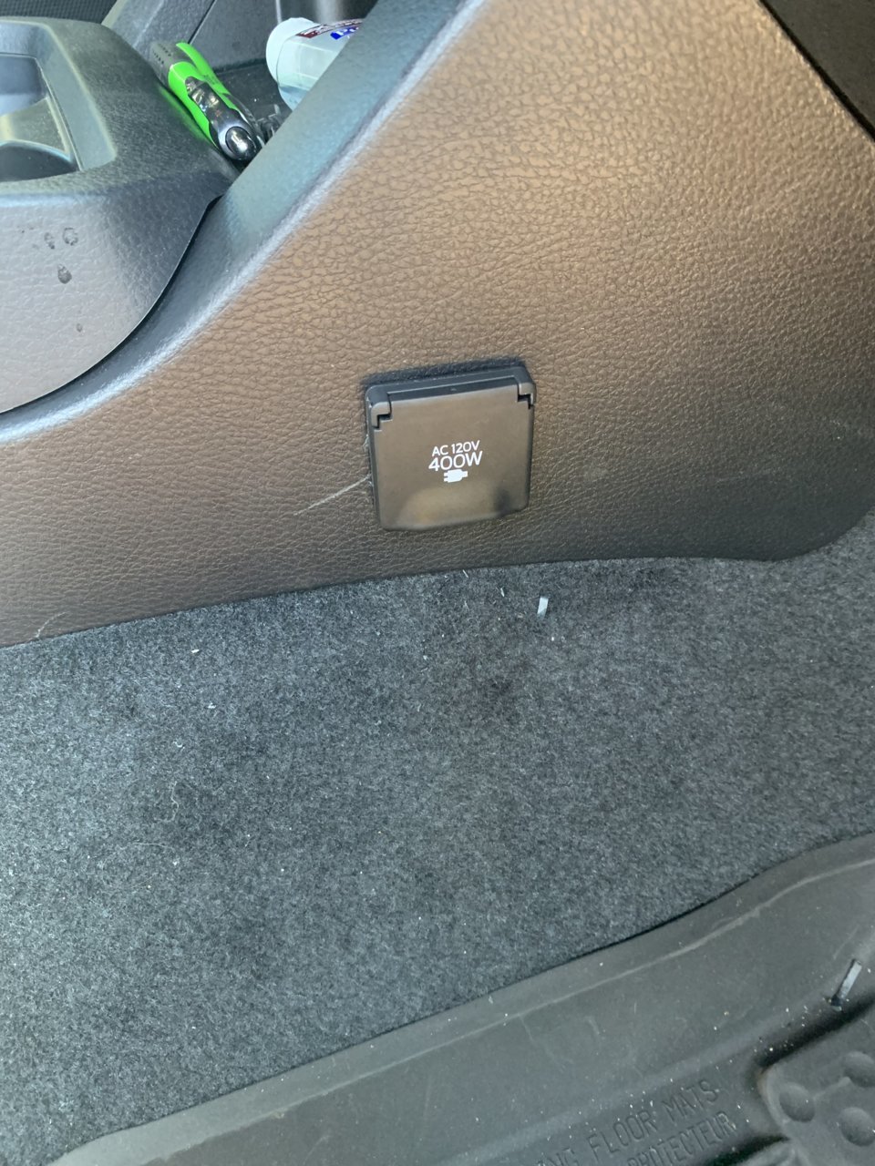

    Put mine in yesterday. Really nice to have an outlet in the cab option. I put mine in the center console so it is accessible, but to me doesn't look out of place and could be mistaken for a factory option. :)
    Centered it in the back and put it low enough to clear my drop in center console organizer.
