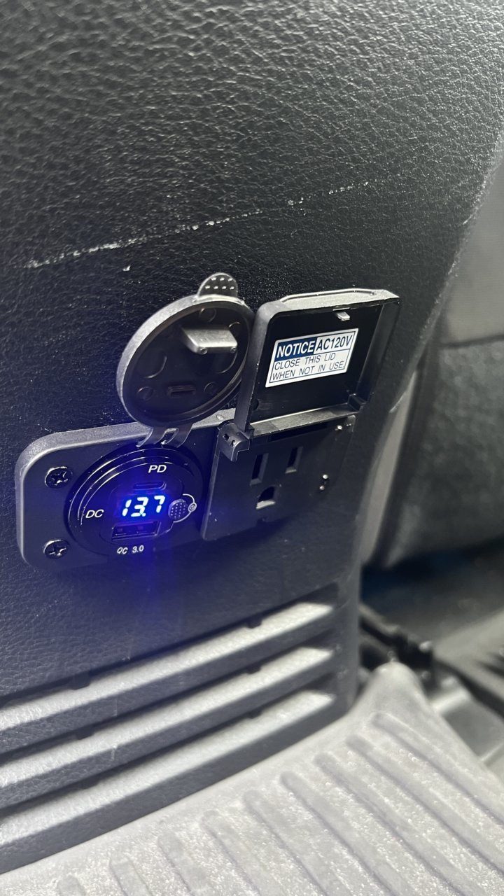

    Installed the 400watt In-Motion Harness with 120volt outlet. Along with the 120volt outlet I installed a usb port in the rear of the center console.
    Thanks @GuildOutfitters
