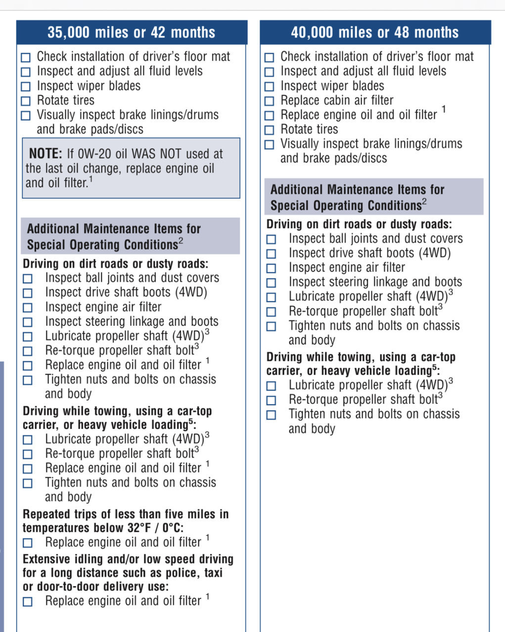

    Hey Everyone, due for my 40k service soon. At what point do you guys stop going to the dealer? Is an oil change the only thing I really need at this point? Sick of the stealership and I'm not getting any free services there anymore... so wondering what everyone does after the 2 year free contract is up.

    I've done oil changes... anything else on the 40k that is a must?

    I have a 2nd gen I am not sure what is supposed to be done for a 3rd gen. Got a pic?

    check the owners manual, it has a schedule you can follow.

    just curious, what kind of picture would help you determine what service needs to be completed at 40k...?

    Oil change, tire rotation, maybe air filters, that’s it. Unless you have visible abnormal tire wear, then alignment then. No fluid exchanges or flushes, no fuel injection cleaning, no throttle body cleaning, and no transmission service. These are common services the dealer will try to sell you.
    also don’t fall for the $300 40k mile service or stuff like that, my friend did that on his corolla and it consisted of mostly the multipoint inspection.

    Pic of the owners manual tells you what needs to be done
