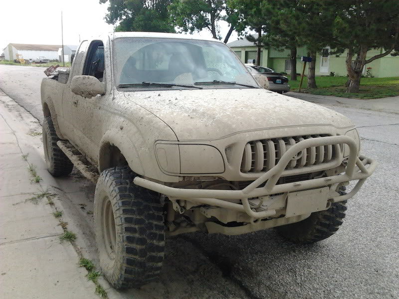

    Turned around and immediately bought a set of 5 Wheeler’s Offroad 15x8 Type B wheels and 33x12.50x15 KM2s!
    Some before & after pics…

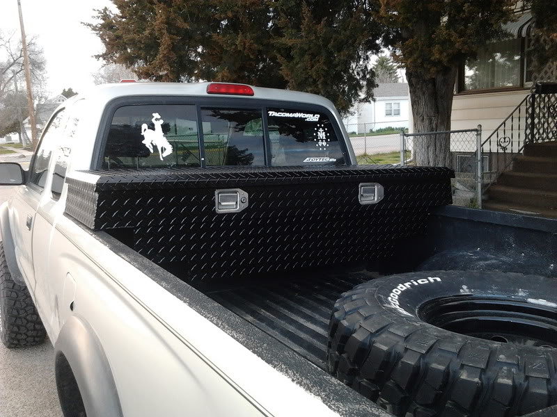

    Soon after that I picked up a Craftsman toolbox off a buddy’s S-10 (it was free!) and refinished it. Also installed a CBI tire carrier and did the deck plate mod.

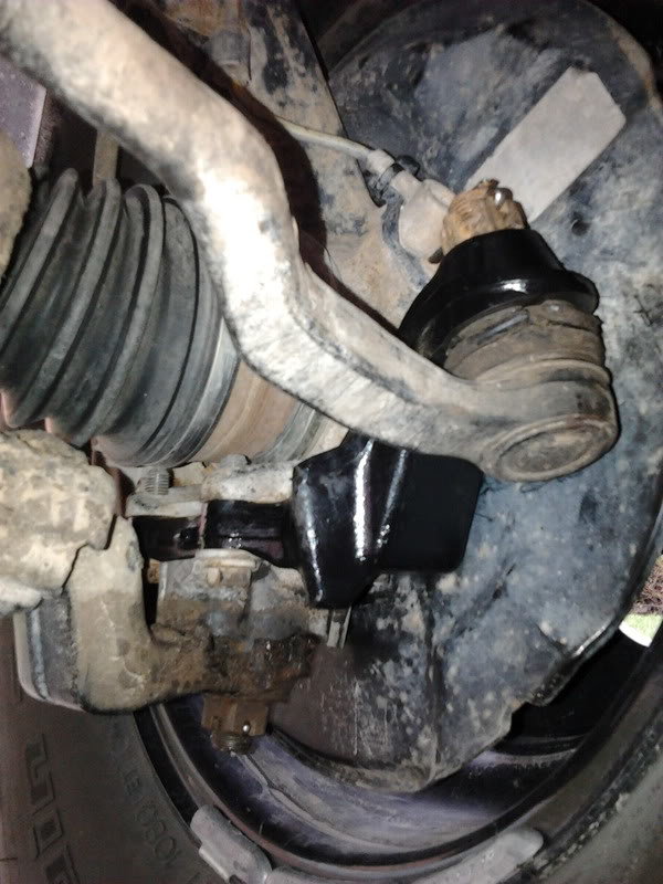

    Found out there was a recall on my truck for the lower ball joints so I wasted no time getting it to a dealer for some free ball joints and an alignment.

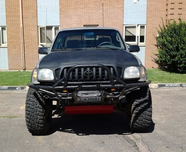

    While in Greeley, I had an Addicted Offroad bumper and Trail-Gear sliders installed, and a Trail-Gear Hi-Lift mount welded to the CBI tire carrier. Scotty does fantastic work!

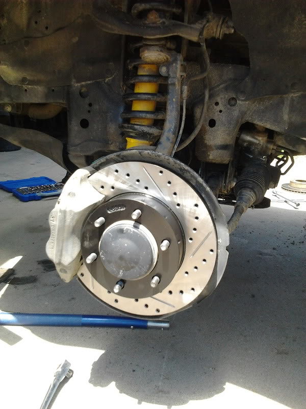

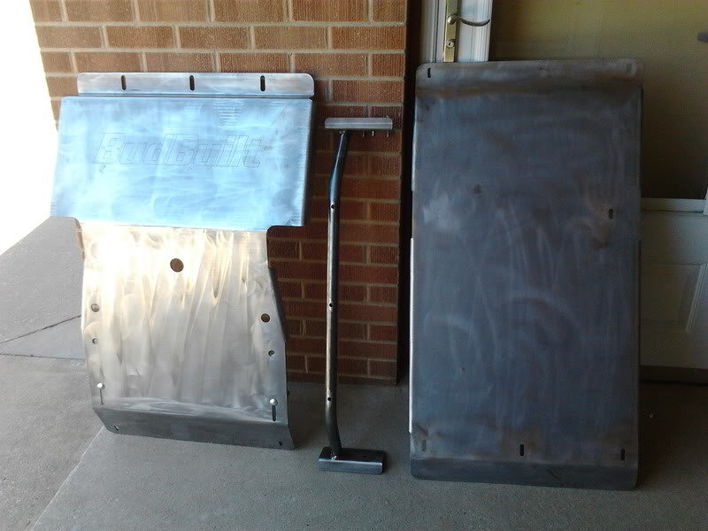

    My brake pads were shot, so I picked up some new ones from Wheeler’s Offroad and decided to get some drilled/slotted rotors while I was at it.
    I relocated the rear diff breather. SO easy.

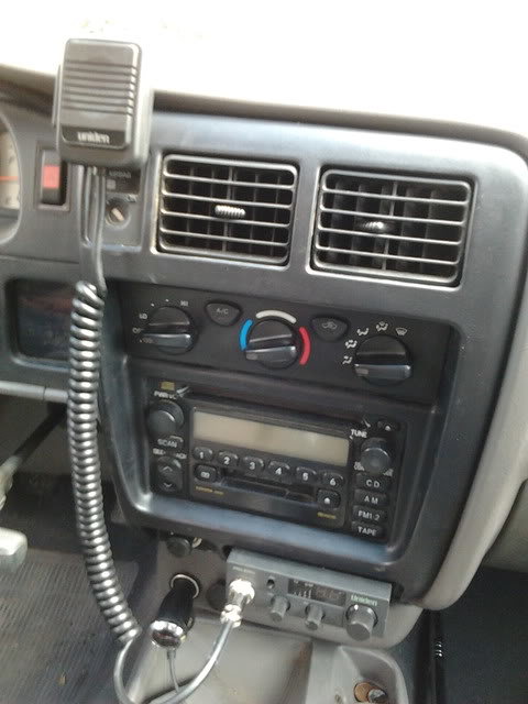

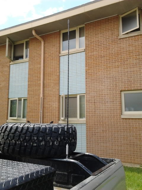

    Installed a Uniden 510. PERFECT fit in the ashtray location.
    And Budbuilts!

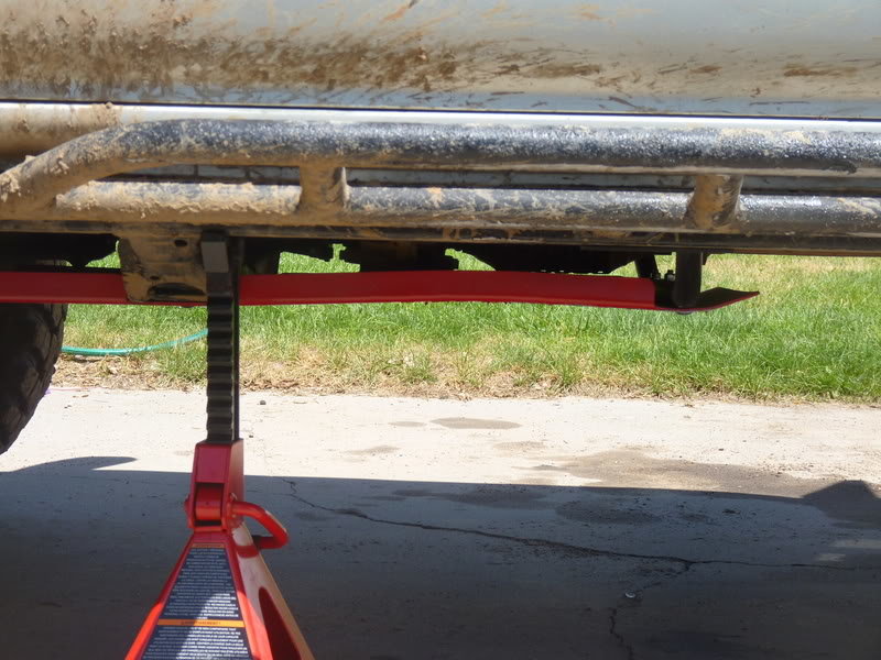

    I bent the belly pan on my first trail run with them. Belly pan definitely needs to be reinforced before any serious wheeling.:facepalm:
    The front skid holds up great though.

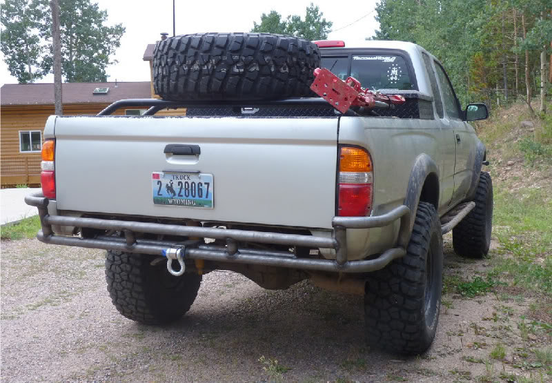

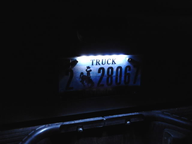

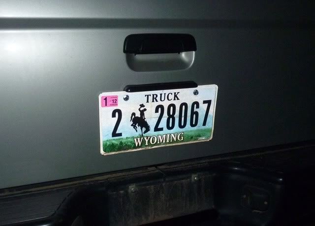

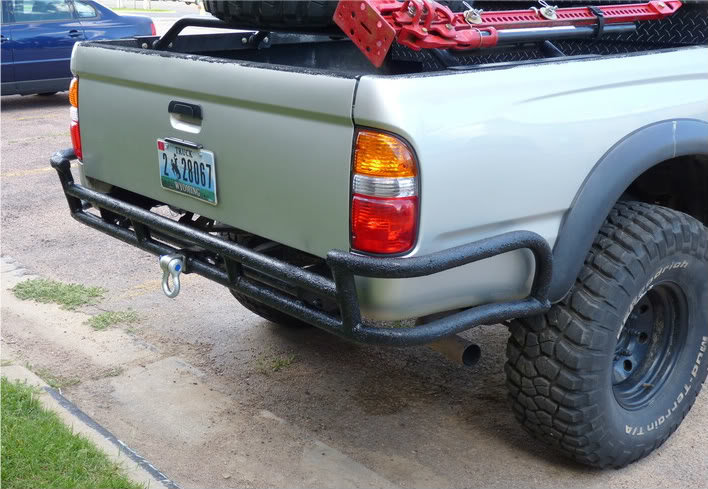

    I decided to get a Trail-Gear rear bumper next. I didn’t want the license plate to get caught on anything, so I relocated it to the tailgate with some LEDs. I bought the LEDs off Amazon without realizing they were for motorcycle plates but I modified it to make it work.
    Picked up the Trail-Gear rear bumper from Addicted Offroad.

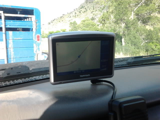

    Installed a Tomtom OneXL

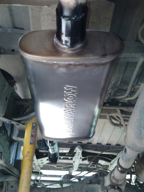

    Had an 18” Magnaflow installed and dumped before the axle. The exhaust was too close to the axle and actually melted the ABS wiring. I got the wiring replaced and the Magnaflow relocated closer to the cab and dumped straight to the ground. The video was made right after it was installed, it actually sounds better after being relocated.

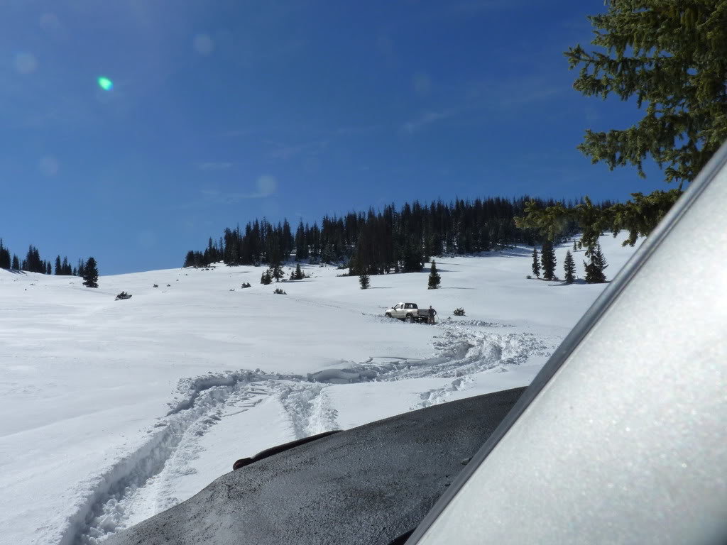

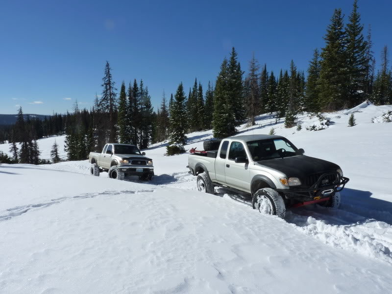

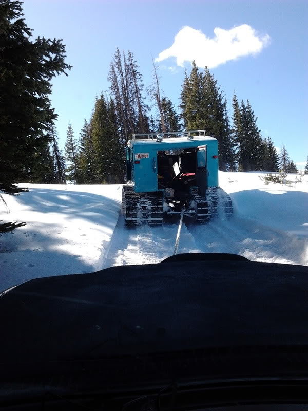

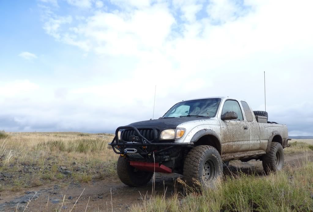

    Did some snow wheeling with pyroskier and he got us both stuck. :rolleyes: :p :D
    SAR got us off the mountain that night, we came back the next day with a guy that brought a snowcat all the way from Cheyenne for us.

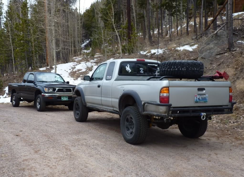

    With my uncle’s ‘95.5 (original owner!) The guy that convinced me to get a Tacoma in the first place. :D
    With WYOTAC

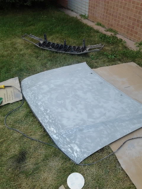

    Haha yeah, I figured I'd be wasting money to repaint it if the hood is just gonna most likely get damaged again.

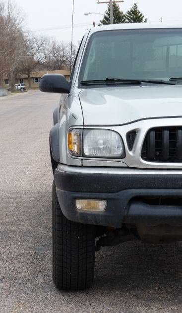

    I suppose I do. :D I'm running stock size Bridgestone Blizzaks as a dedicated winter set. I like to try out different tires for the 'experience'.
