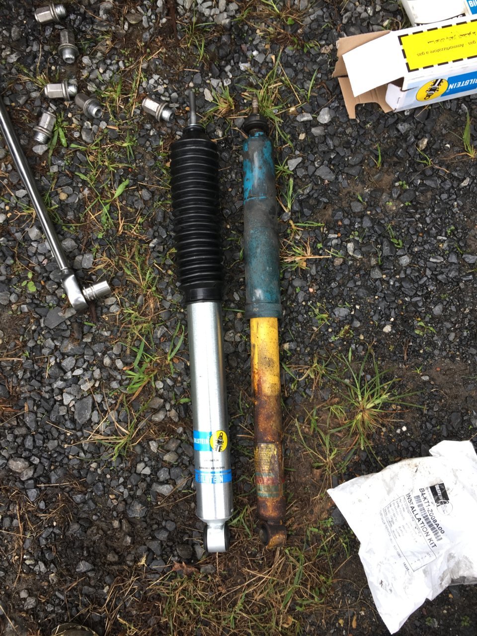

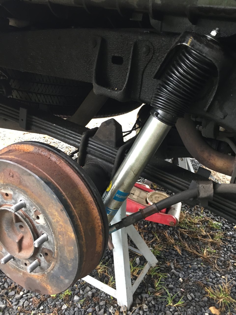

    Just replaced my rear shocks with 5100s. You’ll need a 5mm Allen wrench to install them (top keep the top stem from spinning while tightening the nut).

    Extended?

    WAT?

    Normal length or extended length?

    Normal stock height
