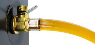

    I bought a car once that came with this valve. So started using them.
    Makes oil changes easy. Especially if you occasionally use the quick lube places. No more worries about them stripping or not tightening the plug.
    You can find them on Amazon too. Cost is about $25.00
    I've had people tell me they might open if I run over a cardboard box or something.
    Each to their own.
    https://www.fumotooildrainvalve.com

    those valves are cool, but i would rather have real plugs and not worry about shit
