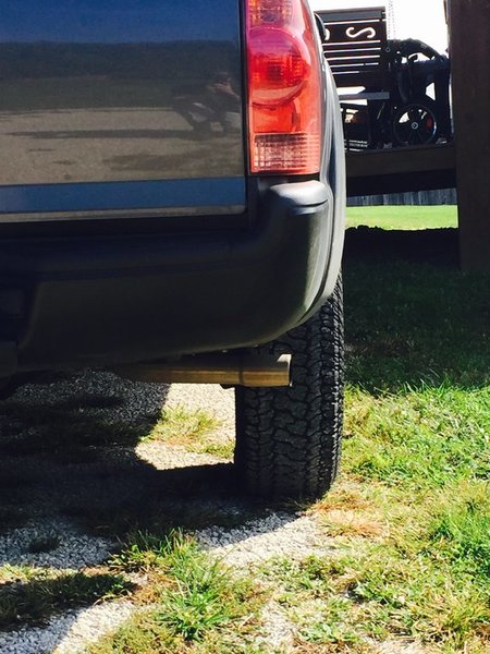

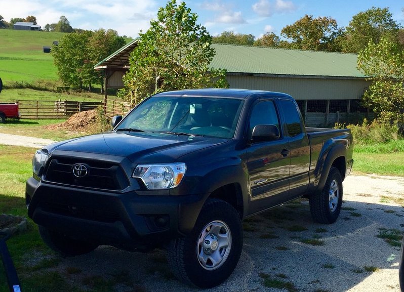

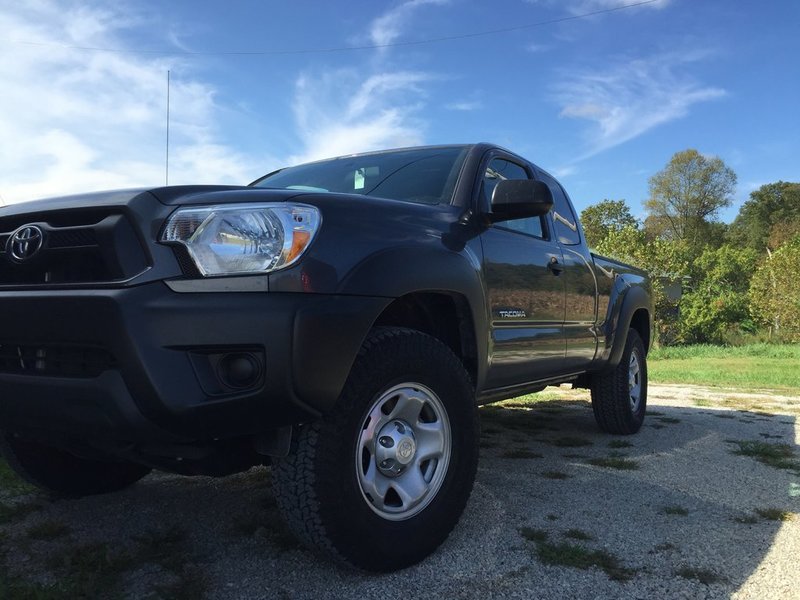

    Well here are a few pictures ill try to get some better ones from better angles parked on level ground sometime loving the tires so far.image.jpg image.jpg image.jpg image.jpg
