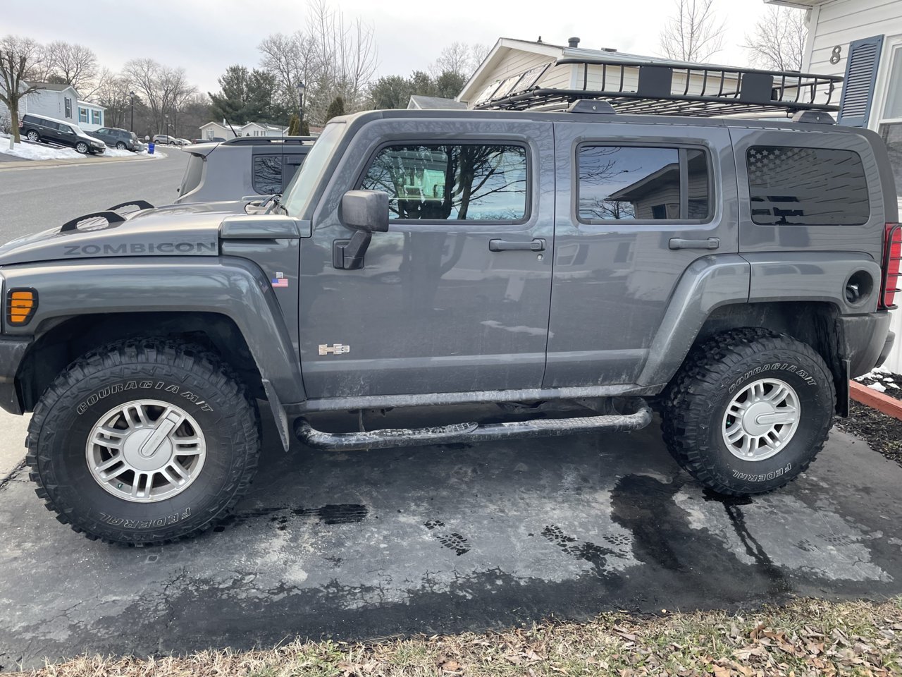

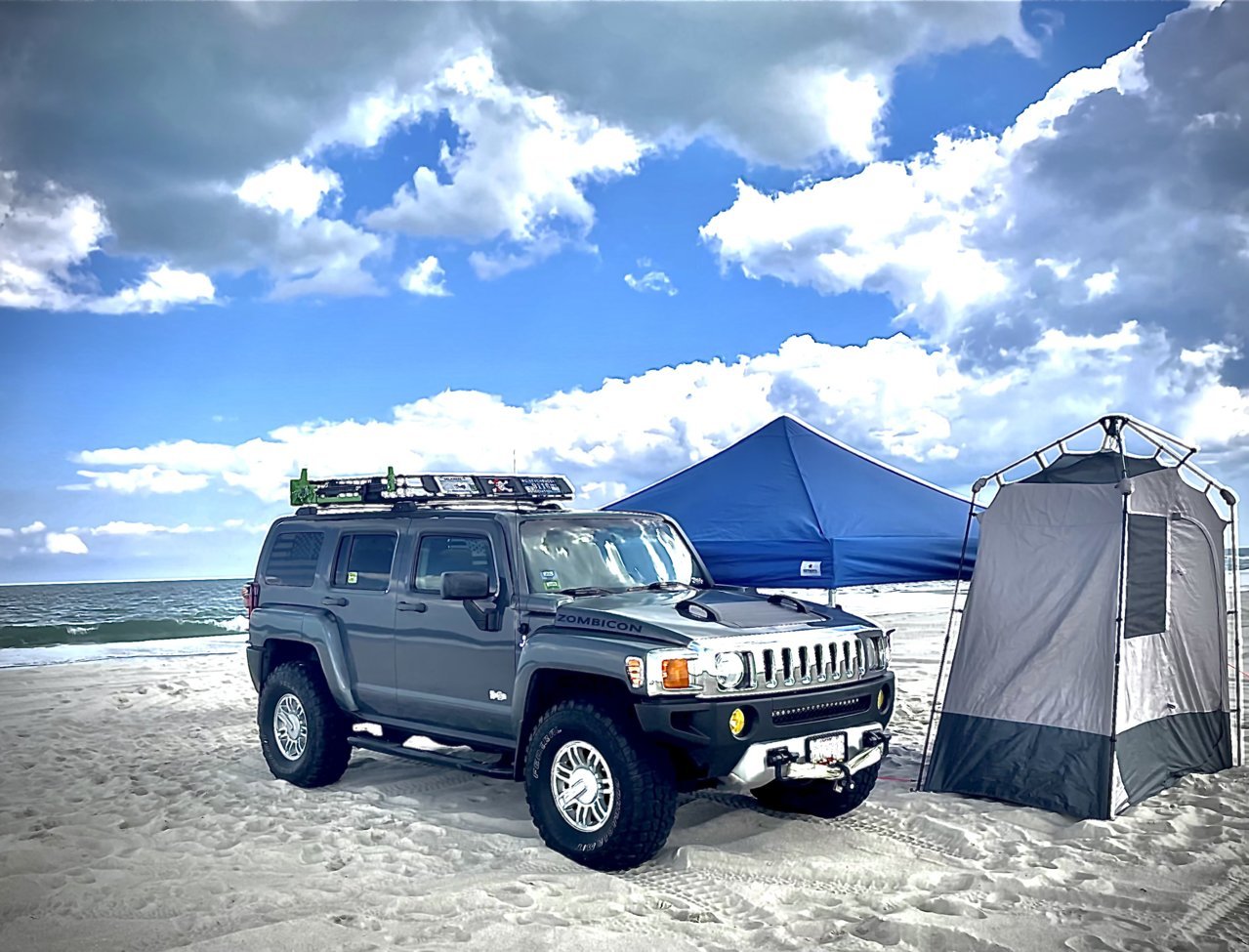

    No idea on the new frame, dealer sisnt really five me a straight answer on wether it was comped or he had to foot the bill but based on their listed price i soubt he had to pay for to frame & replacement suspension components. All i know is ive been hawking the truck on the dealers lot for like a month, just before i went to pull the trigger on my trade, i noticed it was gone, then 2 weeks later it returned with the listed repairs. I ended up trading my H3 for it straight up, wasnt sure at first as the H3 was much nicer in the cabin and a lot bettoer offroad with 35”s and front/rear locking diffs, but i needed a truck and now that i have my taco, im enjoying it aside from this issue.
    old whip:
