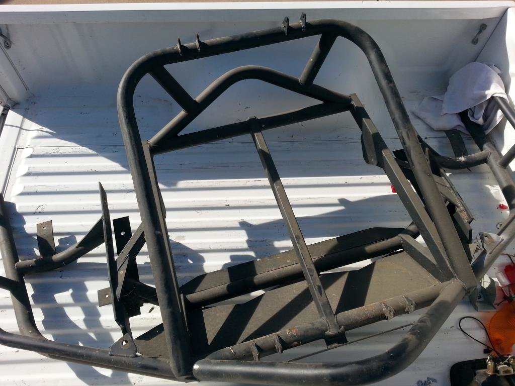

    124" I moved axle forward almost 2" in back....it hits the front leading edge but I'm chopping the whole back half of the frame off if I link.
    Its 2" shorter than my ex cab which was 126...ID like to get 118 but not going to happen with 4 doors without some major modification....and I've almost flipped over backwards and
    Frontwards with this wheelbase....so Its a good base in my book...lol

    Its BEEFY too, has a little surface rust other than that is good. You would need to shorten the bed side protection, drill mounting holes in your frame and cut the bed for the tire carrier part but that would be easy haha

    Well this is a bad ass bumper. If I run it I'm going to cut the tire carriers off which would be sad but oh well. I'll make you an awesome deal, if youre interested pm me

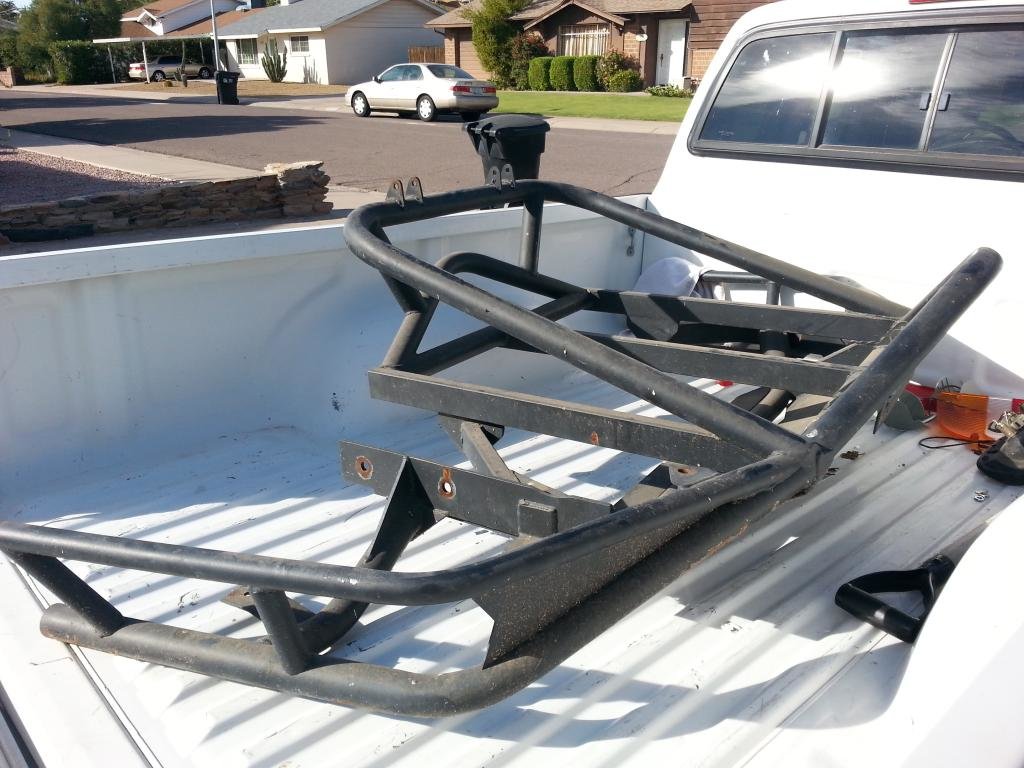

    You got an SAS tacoma on damn near 40's, the southern trails are going to eat that thing up lol!! That's honestly what makes a lot of the hard trails in harlan and the like well... hard. I'm fully confident i can get the taco through them if there was not a huge rock sticking out the side of a hill, or a tree stump waiting to cave in my windows..
    Bull crew: Im interested to see how that rear shock setup/cage works out tied to the bed. I would be curious to see if it causes and stress cracking or tearing on the bed over the long term.

    It won't because its a column load up and dual tubes boxxed in...there's no real lateral movement...
    It has very few degrees of side to side so there isn't any other stress seen....the rear cage will be tied in anywase soon enough...it won't cause cracking or stress that will come from bed flex from hammering down and the mounts...
