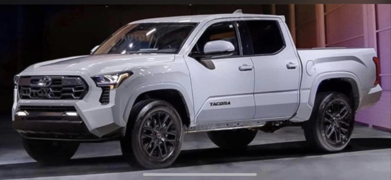

    Those wheels are going to be a nice upgrade on my new 2023 Sport. All I need now is a part number.

    You'll need to machine out the wheels to your truck's 106mm centerbore or run lugcentric wheel spacers.

    Are the wheel specs already out for 4th gen?
    I'm hoping they still stick with 106mm, but both Tundra and Sequoia are 95mm, very likely 4th gen Tacoma will be that too

    ^Just going by the spy shots showing a smaller centerbore and what looks like high positive offset, so spacers needed to run them on 3rd gen.

    yeah, it's gonna be problematic for those who want to transfer their 3rd gen wheels to their 4th gen as well.
    What looks flush for 3rd gen offset gonna poke on 4th gen

    ^A lot of things won't be known until someone tries it. For example, 16" wheels may no longer fit due to larger calipers, like with the 4Runner after 2010.

    It would be interesting to see if they put the 17" front rotors on the 4th gen like they do on the Hilux Rogue. That would be some serious brake hardware to upgrade a 2nd or 3rd Gen.
