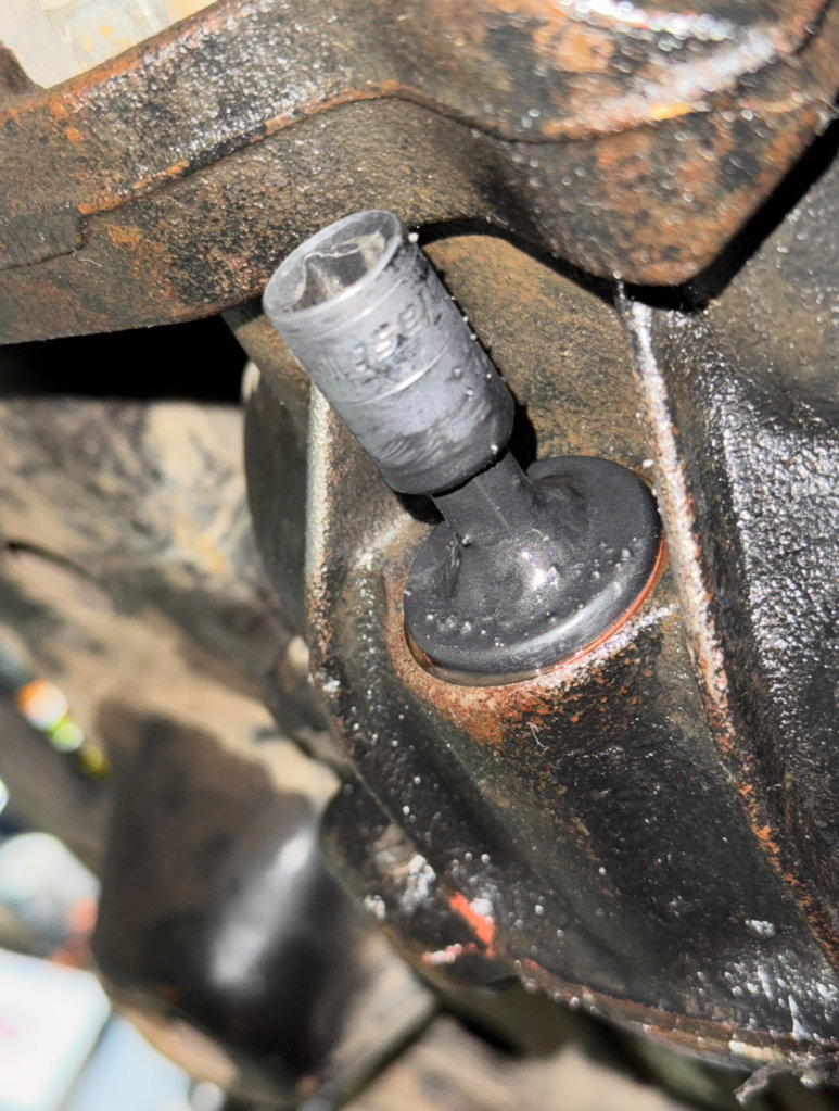

    Just make sure you use a digital torque wrench to tighten the drain plug; they easily strip. You can also replace the drain plug with the Lexus version, which has a male hex head instead of a 10mm allen keyhole, so it doesn’t strip as easily.

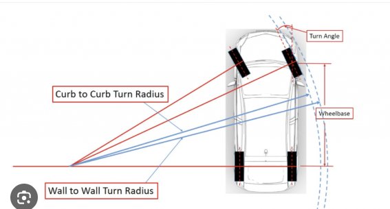

    The outside wheels also turn in a bigger radius than the inside wheels and that's where stress at the diff happens

    Here you go:
    https://ebay.us/m/UgeG5Z
    Or go nuclear on it and weld a ratchet socket onto the OE drain plug. It’s the only thing that 100% will not strip.IMG_9776.jpg
