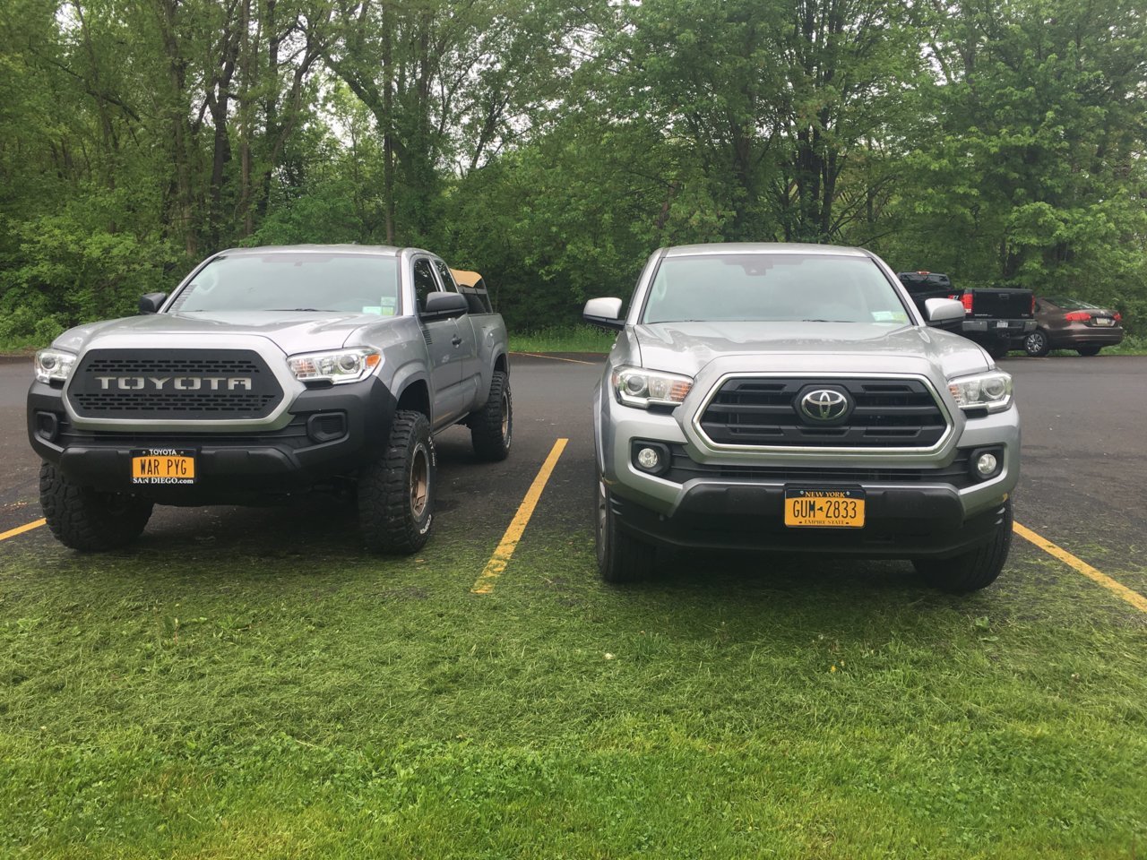

    Spacers=bad, read the sticky thread on lifting a Tacoma. When your done reading it, go read the 3rd gen build threads. There are people on there that have built on minimal budge to unlimited budget. Took me a year to decide the proper route for my needs.

    Welcome. Your Tacoma is off road ready as is, enjoy it. Uniballs can be a noisy pain. Spacers can be damaging, depending on the size. For a solid level and no geometry strain, go with the toytec 1/2 spacers. You won’t need UCAS.

    The best 4 inch lift would be a spindle lift kit.
    Look up Camburg or MaxTrac.

    Lift does not fit bigger tires. 265/75 16
    Or 265/70 17 are the biggest your going to fit. Anything bigger requires cutting, trimming, and hammering.

    Lift does not equate to more ground clearance. Bigger Tires = more actual ground clearance. If you want to fit 285's you don't need a 3" lift, but do what you want to do, your money your truck, enjoy.

    You can do 3 inch and clear those tires with the right wheel setup and offset
