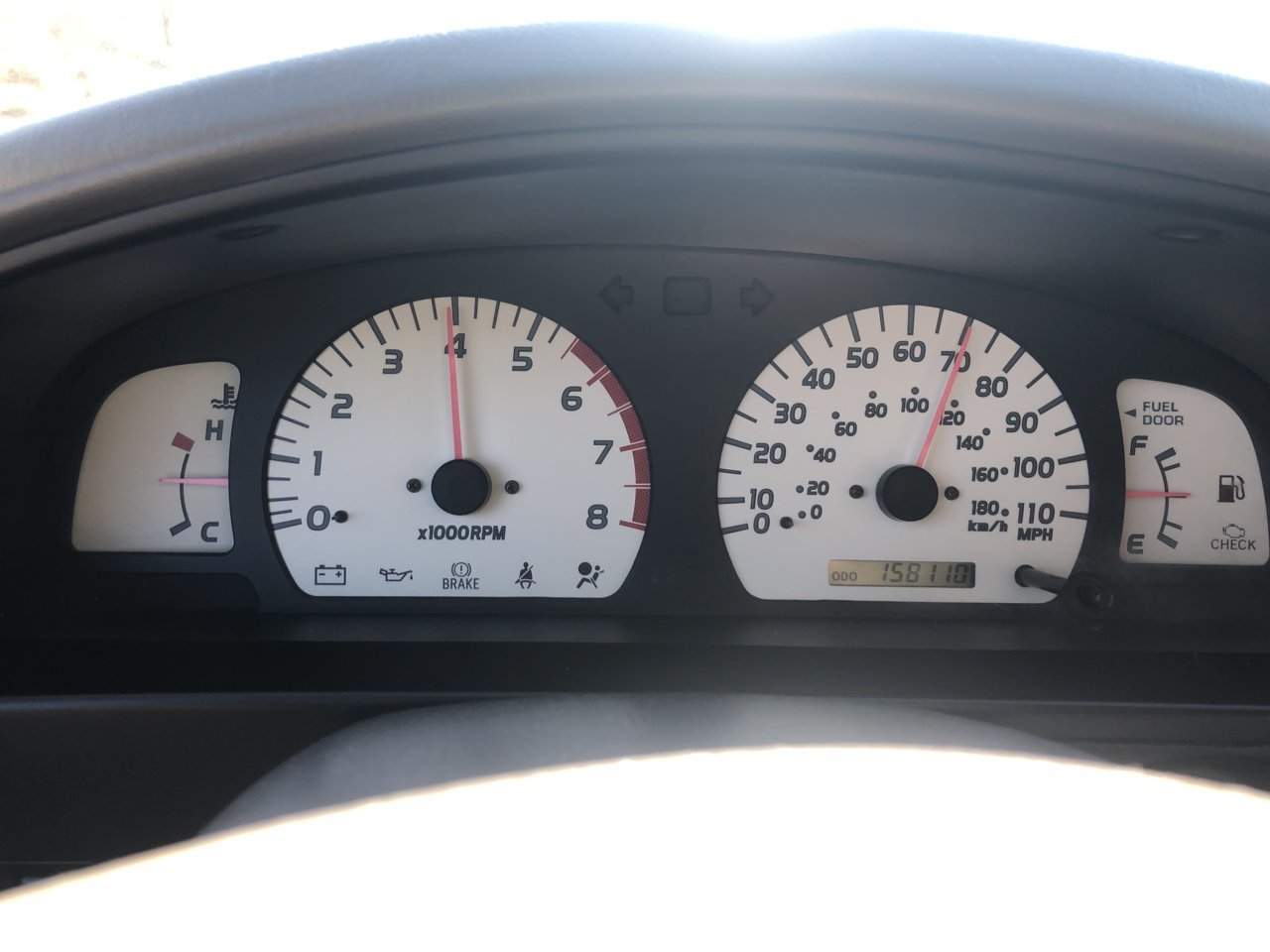

    EDIT: Been away from the truck and MIA from this thread for a while but these are the updates:
    - truck is NOT re geared
    - trying to troubleshoot if tach matches actual RPMs
    - current theory is that gauge cluster was tinkered with really hope thats not case or that previous owner fucked with anything important
    - if OBD confirms tach reading is off i may talk to @mechanicjon about re-programing the odometer module which will, hopefully, fix it.
    - :notsure::annoyed:

    Are you using an aftermarket tachometer?

    gonna do this for sure to get an idea of what im working with
    here's a pic of the dash in the top of 5th on the highway just to show it literally. compared it with a gps speedometer and its only off by like +3mph from the wheels.
