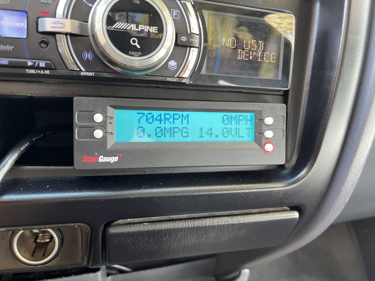

    Maybe if you post speed and RPM’s in other gears we could figure something out. Like 4th at 50mph and 3rd at 35mph, etc.

    This makes sense. If you have an OBDii reader with an rpm readout, it might help

    I think someone messed with the cluster. Maybe took it apart and didn’t put the needle on correctly. Looks too new to not have been messed with. Only way to tell if it’s correct is to read the rpms through obd.
