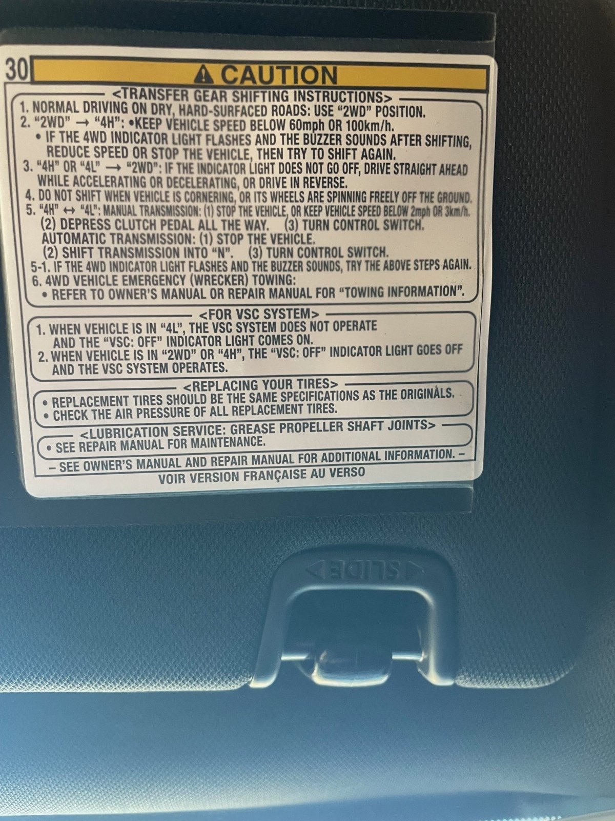

    When sitting in the drivers seat, look up and follow the instructions printed on the card.

    Do you have an automatic? Are you following the shifting procedure? 4Lo will not engage unless you do the following. The beeping is telling you you are not in 4Lo.
    Stop>shif to N>Tur know 4Hi to 4Lo
