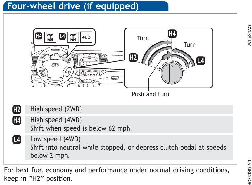

    Right from the owners manual

    Their wording is kind of confusing for some as it doesn't differentiate AT ("shift into neutral while stopped") from MT ("depress clutch pedal at speeds below 2 mph")

    I agree they could word it differently, because shifting into neutral with the MT isn't required. Hopefully the AT guys aren't looking around for a clutch pedal :rofl:
