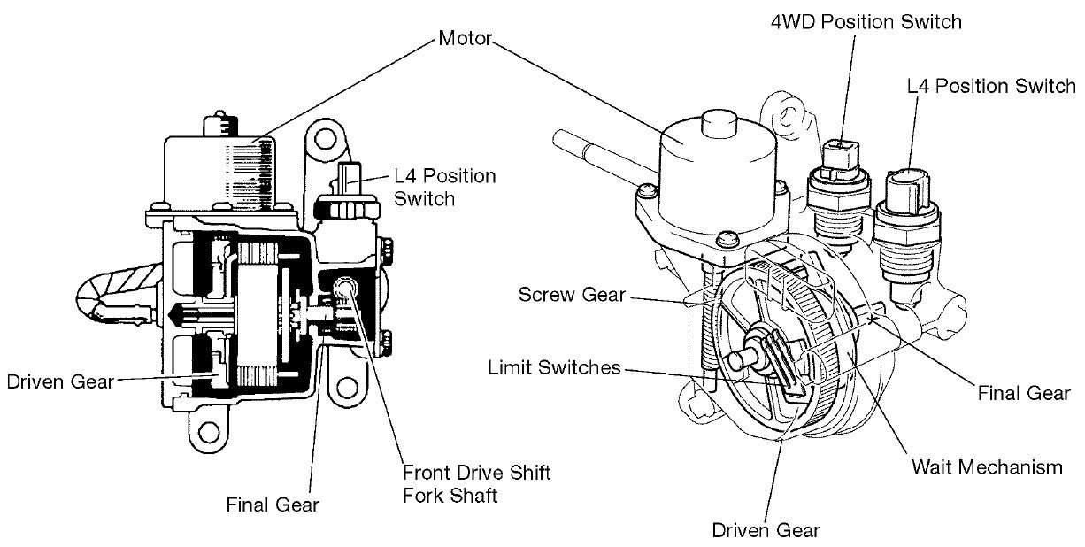

    This is an odd case for sure.
    That rod that slide in and out, physically pushes on the 4Lo position switch. The rod almost had to be going all the way out. Other wise the 4Lo light would not stay on. Strange case case for sure.
    Something is “physical” off here. I don’t think this one is going to be electronic.

    The 4WD ECU controls the indicator light.
    The 4Lo light should not come on if all the correct parameters are met.
    This is a strange case, without knowing the “coding” of the ECU, we can’t be sure what the actual parameters are. I would want the Transfer case Actuator and the L4 indicator switch to be in agreeance before the 4Lo light would be turned on.
    This is one that @Dm93 could probably figure out.
    According to OP, his 4Lo light comes on.
    But he is NOT in 4Lo. To me, this says that signal for the light is based on the Actuator signal, and not the L4 indicator switch.
  11. Mar 8, 2023 at 11:39 AM
    TnShooter
    TnShooter The TacomaWorld Stray
    Sep 2, 2010
    #42625
    21,096
    Deogee
    07' TRD Off-Road, Auto
    STOCK
    For clarification, this is the position indicator switch. C82CD66A-B61D-4BFE-A1BB-98C1F9921932.jpg

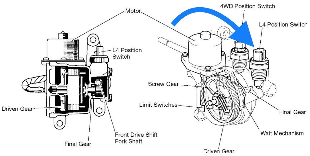

    I could test and see but I'm almost certain the 4wd ECU will not turn the 4LO light solid until it sees the L4 switch close.
    Theoretically there should be now way for the switch to be closed unless the transfer case is fully in 4low but it seems this is not always the case. Now whether this is due to wear or a mechanical problem in the transfer case or an issue with the Transfer Case Actuator is unknown but I would tend to lean toward a mechanical problem or wear on a shift fork in the transfer case based on how the system is designed.
    I'm not exactly sure how the shift forks are actuated in the transfer case itself having never been in one, I watched the video below but it's not clear exactly how the high/low shift fork operates.

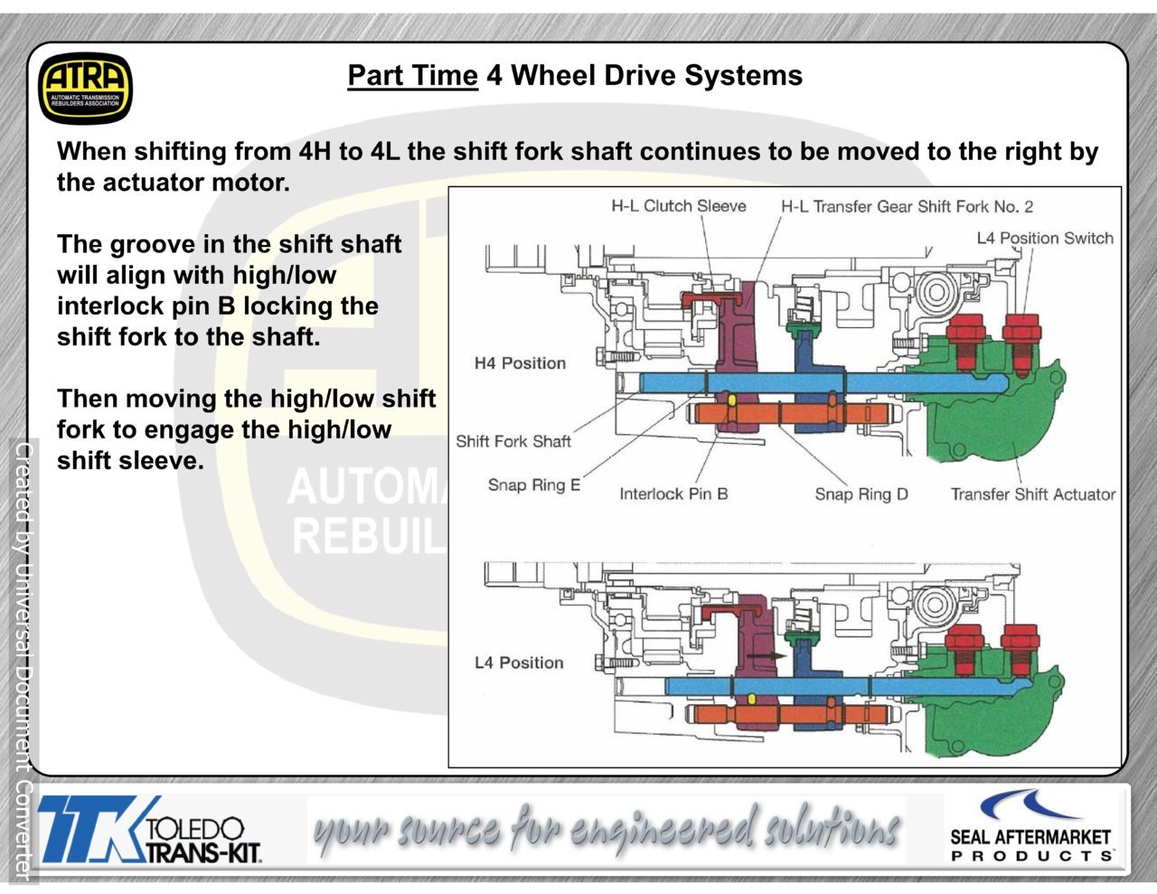

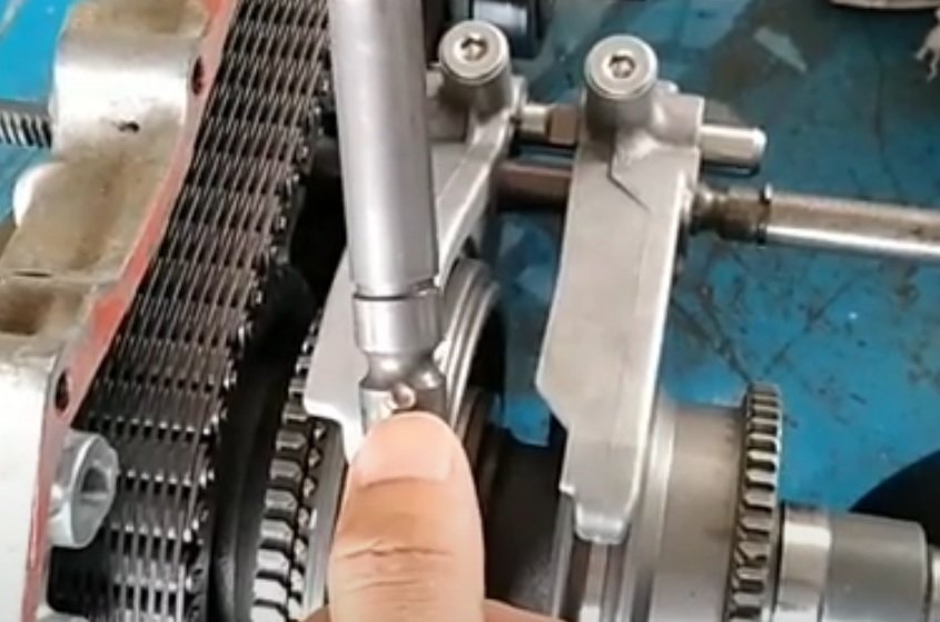

    Interesting, I wish I knew what he was saying. I wonder if the wear shown in the video is a possible cause of this problem.
    I did find this, pretty good explanation of how it moves.

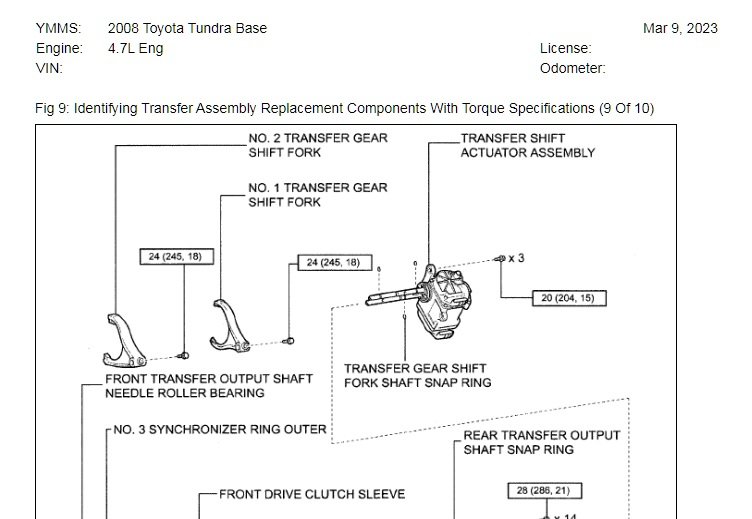

    This video is for the mid-2010's-era Tundra T-case, but this one is probably very similar in design & operation to a Tacoma's, only with bigger parts inside for more load capacity.
    Toward the last 1/4th of the video he uses 12V power to force the actuator to actually move the shift fork in & out.
    https://www.youtube.com/watch?v=4UoBCIjWIoU

    I watched it, while the shift forks move in a similar fashion the way they are interconnected is quite different from the Tacoma as both shift rods are part of the actuator on the Tundra transfer case.
