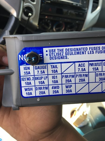

    What did you use to connect wires to this

    Those terminals are pretty small and best suited to soldering the wires onto them, with heat shrink added before by slipping it over the wire, then back down over your solder job that way there is no chance of them shorting out.
    You might be able to get a smaller lug terminal on them but it isn't really what it was designed for.
    If it's all you have go for it. In this case the connecting of those wires just puts the truck back into the OEM wiring condition.
    Pirhett likes this.
