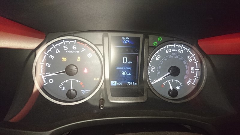

    was hunting in the mountain and using 4lo for some bad part of the trail. got to the easy part and try to turn off 4 wheel drive. nothing happen beside the green light turning off, but the traction light was still on and the 4lo was blinking. try different thing for 30 minutes but it won't disengage. turning the 4 wheel nob do nothing. so my hunting partner drive 3 hour back home to pick up my brother tundra and a trailer to come get me. while waiting to 6 hours for him to come back i try to get it out , but it was still in 4lo. got home 30 minutes ago. going to call for roadside assistance to come tow my truck in the morning to the dealer. Anyone had this issue before?

    Did u try to to drive in reverse about 15'? My buddy had this problem and the dealer told him to do that and it disengaged. Hope this helps

    i try all that. usually when i have it in 4lo the green 4 wheel light come on to, but it off and the 4lo is nursing blinking . plus turning to 4 wheel nob doesn't do anything and it doesn't make a noise that i usually hear. it there a fuse that control that 4 wheel nob, maybe it die

    I remember seeing this problem on another third gen a while back. The dealership ended up having to replace the entire transfer case. Just an FYI.

    i try that while in the mountain and just now in my drive way. didn't do anything and didn't hear any noise that while turning to nob. guess I'll just hope the dealer can fix this issuse in one day. cause it's raining on Friday and i need to get back to the mountain to get my last deer.

    I'm guessing the actuator is stuck or the transfer case took a crap. Good luck

    I can only go into and out of 4Lo in Neutral. Go into neutral, press the brake pedal. Then switch from 4Lo to 4Hi.

    Same. I always stop, put it in neutral, and go to lo or hi. You can't change in/out of 4lo while moving due to the nature of the system.
