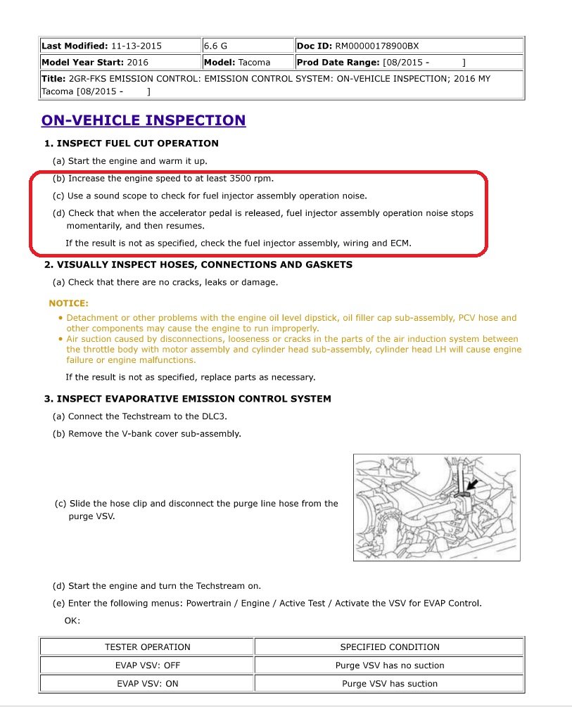

  19. Jun 26, 2017 at 6:31 AM
    #19
    MOC221_
    MOC221_ 3 pedal metal
    Feb 20, 2016
    #178858
    7,821
    Frank
    2019 DCSB Sport M/T Barcelona Red
    vF Tuned; ADM; Core SS
    SO it's time to eat some tasty crow.. well kinda. Here are some references to "fuel cut operation" from the service PDF (thanks Splitbolt):
    Edit: After reading Para 1 (d) again, it occured to me that a "momentary" fuel cutoff would be in play because this test is not performed while the veh is being driven. So the fuel cutoff would only be active for the time it takes for the engine to drop from 3500 to around idle speed (or maybe 1300?):
    Now this is more in line with what we've been talking about, at least when the engine braking resumes at the high end:
    I've been looking for full descriptions of fuel cut operation, but so far it's just single line references such as these.
