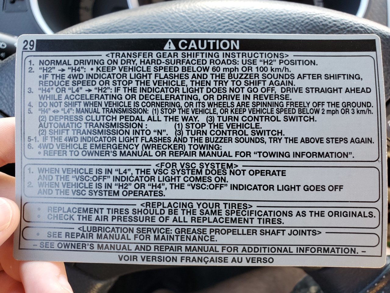

    If its flashing or beeping it's not engaged.
    Check the drivers sunvisor for full operation instructions.

    To confirm for everyone... If the 4x4 logo or 4LO logos are flashing the system is NOT engaged.
    Furthermore, if it is beeping when you go to 4LO the system did not engage. The beeping will stop and both 4x4 and the 4LO lights will turn on when it's ready and working.
    You must be in neutral to go to 4LO on 2nd gen's, auto tranny. The information card in your driver's seat visor has all the information you need.
