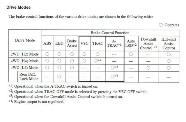

    This wouldn't be the same signal wire that everyone is trying to wire the opposite way to get rid of ABS in other modes other than 4low is it?
    I could see that maybe, that this wire signals something to turn off the ABS in 4 low, and now doesn't. Leaving you with ABS in 4 low where it does not from the factory.
    Is it a different wire? If so... has anyone figured out how to do the ABS remove in the 09-10 without removing VSC and TRAC? It seems, from my reading that the current ABS mod would kill this mod. But again, its late and its a lot to read, and a lot of threads with misleading titles pre 09 vs 09+.. I may be confused.

    It is not the same wire, and I do not believe it activates the ABS system in 4L. But I no longer own the SR5, and someone else will have to answer this......

    Are you saying that 4lo DOES disengage ABS??
    I hadn't been able to find anything to say that it does, and I was looking forward to the day (not really) when I would try to lock up the brakes in 4lo and get hosed instead.

    According to the tech sheet the ABS is only off when the rear differential is locked. In Low Range the VSC and TRAC is off, not the ABS brakes...

    Ah.. looks like I should have read this sheet instead of someone else's post.. it appears that ABS is always on in a non TRD OR truck, since i don't have a diff lock button. At least after 2008.
    Well then, that makes it even more interesting. I'm a bit of a motoring purist. i don't mind some "safety" stuff. Traction control works great on these trucks and is welcome 90% of the time. But this tacoma isn't my 80s trucks or 99.. its a robot that takes me where I want to go. I've got the helm mr sulu.. you can take 5 and let me drive for a while. I've not had much experience with abs in snow (it wasn't available on most things back when I lived in snow), but it seems like, if its anything like rain, it'd be downright scary (at least at first), and i'm not 18 any more, but it also seems like its no fun.

    ive locked up my brakes in 4lo on steep descents...
